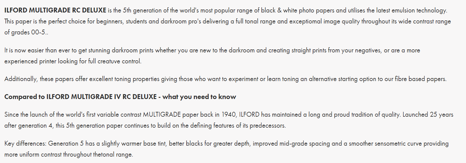

The "Multigrade RC Deluxe" web page states: "The 5th generation of our MULTIGRADE, Resin Coated, variable contrast black & white photo paper." Ref.: https://www.ilfordphoto.com/multigrade-rc-deluxe-glossy-sheets
The old(er) RC paper was called "MG IV Multigrade IV RC Deluxe." So maybe if it doesn't say IV it must be a V?

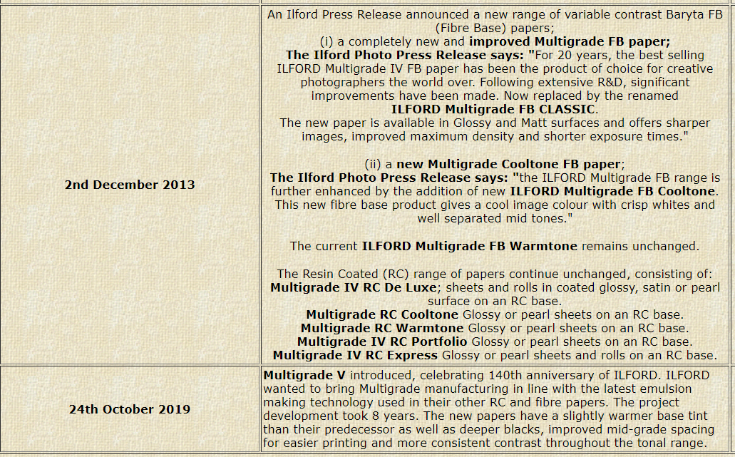

As I understand it @Nicholas Lindan , the FB paper was updated in 2013, while the RC paper update took another 8 years.
Here is the informationfrom the photomemorabilia site devoted to Ilford Multigrade, found here:
https://www.photomemorabilia.co.uk/Ilford/Multigrade.html
And yes, despite the fact that Harman doesn't call the latest RC paper Multigrade RC V, they call it that on that site.
And for what it's worth, even though there is no "V" in the name, Harman's descriptive wording is full of reference to 5th generation - from the product information on the IlfordPhoto website:
