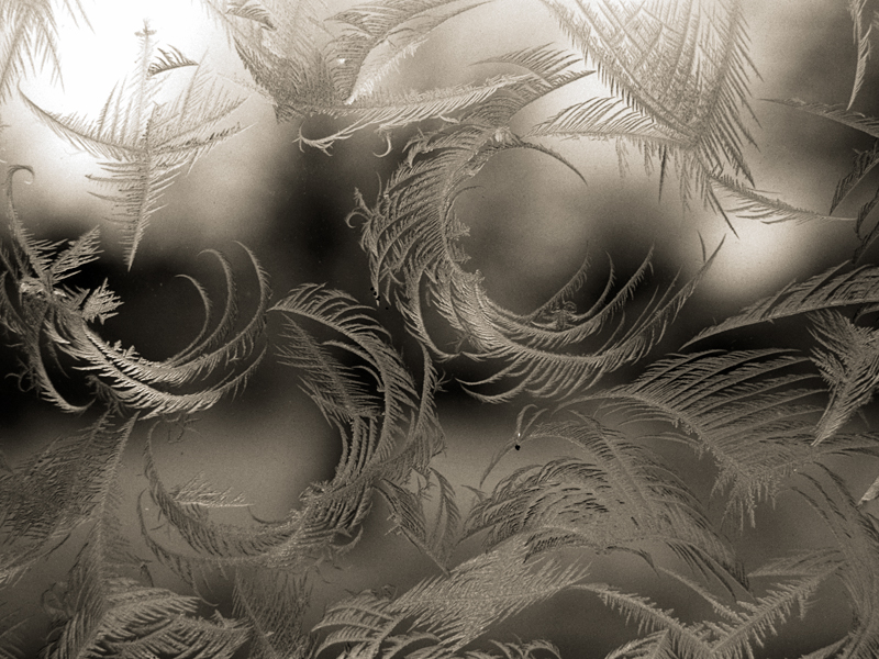

We will see if your assumptions are correct or not. I am well familiar with how agitation changes can alter a film curve, and try to use it to my advantage as much as possible. With Xtol 1+1 it has been really interesting to take TMax 100 and Acros, under-expose it by two full stops at EI 400, and then overdevelop them while slowing down agitation.
This brings back shadow detail, but will look more like the old Kodak Tri-X 320 (TXP), and the shoulder created by the agitation change will also make it look like TXP in the highlights. Mid-tones remain normal.
Attached it an Acros example.
- Thomas
That's better. Published results. Thank you.
If I find time, I'll report back to this thread.
Here is a frame of TMY-2 400 in XTOL 1:1. Contrast looks nice. Lots of shadow detail (at least on a properly calibrated monitor...)
