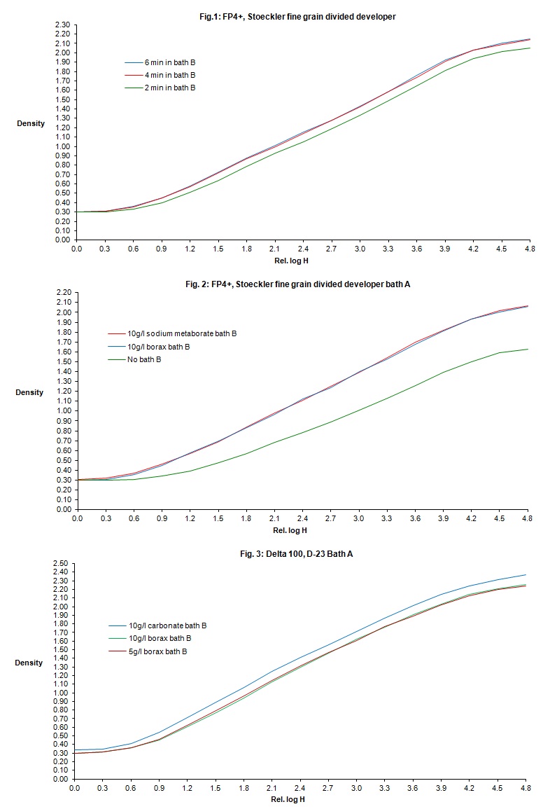

The BTTB formula I've seen is a trivial / insignificant adjustment to Adams's version of divided D-23. The BTTB first bath is essentially a slight dilution of D-23 which doesn't make a difference. From a photographic perspective the altered concentration of metaborate in in the second bath also makes no difference. The Stoeckler version (and several others) also give the same sensitometry results.

BT explained his variation:
By modifying the time in the first and second baths, it should be possible to get very similar results with AA and BTTB.
One criticism of these two bath developers, from a sensitometry perspective or otherwise, could be that there is no principled or wellfounded crtiterion for splitting the development between the two baths unlike a truly divided developer where all development happens only in the second bath.
There is though. With this type of two-bath (ie where bath A is a fully functioning developer), contrast is controlled by development time in bath A. That's about all there is to it. Bath B goes to completion/exhaustion but is not a control for contrast.
Some illustrations:

Thanks, Milpool.
Thank you very much Milpool for sharing those HD curves! That is exactly what I would like to see for the long time.
What was time in Bath A? Was it constant or variable?
I'm surprised to see that same amount of borax and kodalk had basically the same effect.
From my experience, 4 min in B gives very different results from borax and kodalk.
In some other thread I mentioned that I tested only B development (in kodalk) after 5-6 rolls of film and I had decently developed film.
So, all that talk about carryover of A being neutralized/exhausted in B, is not right. It stays there and it's active.

Time in bath A was constant - I would have to go back to my old notes to be sure but I think it was 4 minutes.
I didn't reuse bath A or bath B in any of the experiments. It's difficult to predict whether or not carryover into bath B would cause it to develop on its own. It would depend on a number of things such as the type of A bath, volume carried over, pH of B bath and time between uses of B bath (at the pH of say metaborate, an extremely dilute metol-sulfite solution is going to oxidize quite readily).
@Milpool: In connection with Figures 2 and 3, do you also have the curve for a plain water bath B?
@gorbas: to avoid the inconsistencies due to carry-over, a one-shot second bath such as one made up with Ascorbate can be used.
I didn't do any trials with a plain water bath. I probably should have tried it but eventually lost interest (these two-solution experiments were just attempts at satisfying my own curiosity regarding how the work since reliable information is virtually nonexistent, but it was not a technique I planned on using in my photography)
