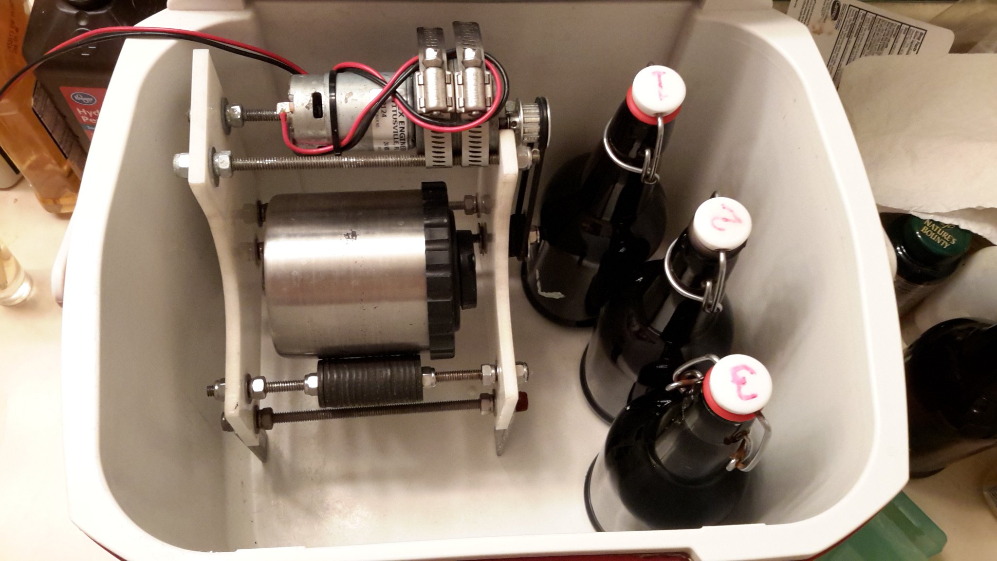

Make yourself one of these and time it takes won't matter.

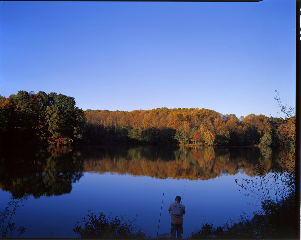

E6 8X10. No projection needed, just hold up against a light source. Ektachrome developed with Arista E6, in the SP-810 dayliight tray.
8X10Ektachrome001ds by Maryland Photos, on Flickr
It is indeed time consuming, and all the shuffling of chemicals and keeping the temperature constant is cumbersome. Another issue is making sure the tank is well rinsed out between each development since the first developer can not handle any contamination.
But when it works its worth it.
