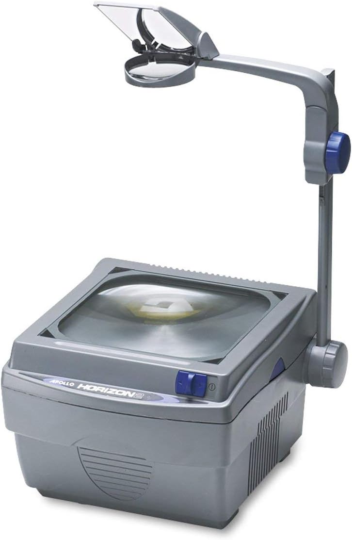

Yep - they work well.
There are much more expensive options that will be usable in a large lecture hall, but those overhead projectors work fine for a classroom sized room or smaller.

Oh man - I've never seen 4x5 slides. I probably shouldn't, unless I want to go bankrupt!
What you really don't want to see is a 4x5 projector!
Although you can get pleasing results in a smaller room with an old style overhead projector.

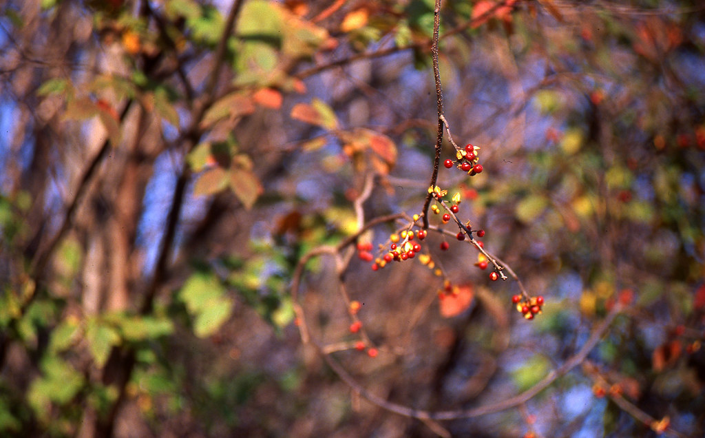

35mm E6 development. This was Ektachrome E100 developed in the Arista Rapid E-6 kit.
EktachromeE100Scans020s by Maryland Photos, on Flickr
When I was first doing E-6 I was getting messed up rolls (most of the roll would be smeared terribly), until I started to really thoroughly wash the tray/tank after each development. The spindle in the tank (I use the Lab box) or some other part was holding on to the blix or something, from the previous (and successful development), maybe.
JW, I developed a 4X5 Ektachrome sheet this morning and your post reminded me, indeed, one side seems almost opaque while the sheet is still wet (although holding against light from the other side you still see the image clearly). Once it dries out both sides are clear.
