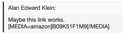

Here's a substitute for $25.
Now if someone would find me my microwave handle please.
I cannot for some reason see the reference. Would you post the actual url without the "//www." so that a usable url can be seen without the
flags which the screw up showing what you are actually posting?
