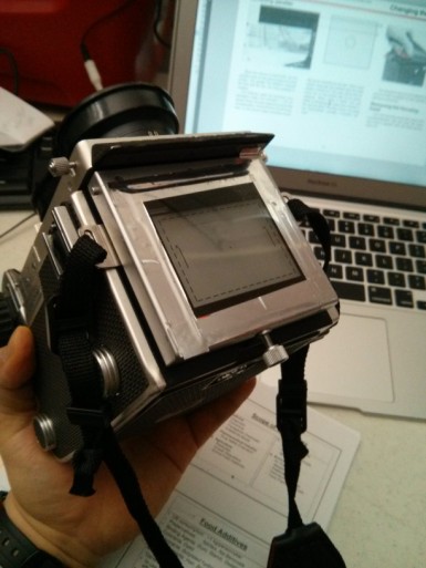

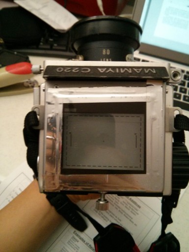

Hi all, I'm new to medium format and just won a C220 from ebay and realized the ground glass is not original.
The original listing did not have a detailed view of the finder and the ground the glass so I had no idea until I received it today.
In the left upper corner it says "Rev. PIC 10/94", whatever that means.
There's a dotted rectangle drawn on the glass(size close to one 35mm slide film) and then the previous owner taped a black rectangular frame on the glass with silver tapes.
I can understand the replacement of the ground glass with an aftermarket piece, but why all the tapes to cover up most of the ground glass?
I thought the whole point of 6x6 tlr was to look into a wlf and see the square image on the ground glass ?
I haven't removed the tapes just in case the seller wants it back in the same condition he sent it.

They may have liked to print rectangular images and masked it off to match how they usually crop.
I'd have never done this though I could see taking a marker (dry erase would be easily removable) and marking the corners of a rectangular frame. I would have done that for both horizontal and vertical rectangles though. I did mark the corners of a 6x7 frame matching my roll film back on my 4x5 GG but this doesn't interfere with it's use for 4x5.

You were right. Couldn't resist the urge and ended up removing all the tapes to see what was underneath. It was actually a clear plastic sheet sitting on top of the ground glass. I guess it was a commercially available product for those who want to crop rectangular images on 6x6.
It is a plastic frame from the view finder of a Camerz long roll portrait camera. I have a Camerz camera which has that thing on top of its ground glass.

The daft thing about masking the ground glass is that all the finders have a recess in the base for holding things like the 55mm exposure compensation scale (useless for a C220 as it does not have the moving parallax bar). This recess can be used for grids, masks, whatever. There is a marginal parallax issue, since it sits just above the actual screen, but it does allow you to put in a grid or composition aid when you need it.
