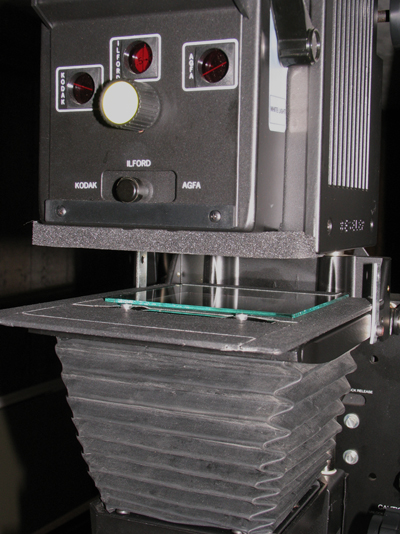

I Use a Self made glass carrier with good results . It is for my 120 negs in a Bessler 23c VC Enlarger. I do not use anti Newton Glass And have had no problems until very recently.(I was actually wondering what newton rings looked like...... I was better off not knowing!) Have had some show up with T-max 100. AM going to replace the top glass with Anti Newton Glass & am currently looking for a source.... and am assuming it is just non-glare glass??? but have had some trouble verifying.
Anyway my carrier isn’t anything real pretty. Basically 2 pieces of glass bottom one masked off (slightly larger Than 6x7 to print border i.e. rebate) With registration pins for making masks and the such.
I was stewing around in my head trying to come up with something fancy( trying to make metal and glass carrier) and settled on simplicity. This is basically exactly how Lynn Radeka’s Contrast Masking Kit explains how to make one. The only thing I did different was to add guides to my enlarger and sand the sides of the glass where they slide in to the metal guides. Everything works good (at least up to 16X20 - largest I print). Have made unsharp, SCIM , Dodge masks and others with success. I would have to say The Information in his Kit is Well worth the Money ( Slimt Dev. Mask making, Formula’s and such)
When I approached making this I Cut the Glass, Put it in the enlarger, removed the lens board and traced the negative stage on the glass, then used this to mask the negative area - making sure the negative fits directly centerd in the lens path.
Best of Luck -
