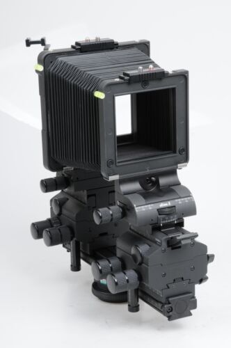

This is either an LF or MF forum. Stuck it on LF as it is after all a full movement view camera.
In the past I was hardly looking at LF gear below 4x5. Now times have changed. There are a few choices in 6x9 format, most as field cameras, more compact and lighter for sure. But not offering full set of movements.
How is LInhof M679 in real life use? M679cs version? Surely could use some comparison, even if for the moment not interested in that kind of spending. There is custom hard case too. Is it worth having for field use, or more like storage at home?
More specifically asking for in the field use, bulk, weight, ease of operation (surely this is not a field camera with relative simplicity). And in all that, film not digital, with film holders and roll film backs. Is Super Rolex roll film back directly compatible, or does M679 have own mounting standard?
I have noticed a slider fo Hasselblad film magazine available, so the is a plus to me.

I've never used the 679. I was looking for 6x9 monorails recently and the M679 was actually fairly heavy--about 10 lbs. The Super Rollex has different variants--the 4x5 variant is the most common and fits any graflok back 4x5 camera. The 6x9 variant is specific to the 6x9 technikas and the 6x9 Technikardan. There is a Super Rollex back specifically for this camera and the Techno, but its not very common, so you're likely to have to buy new. For the 679, the film back I'd want is this:
It allows you to mount standard 6x9 graflox roll film backs like Horseman or or Mamiya backs which are cheap and plenitiiful on the used market.
If you want something more field ready Linhof has the Technikardan 23S--closer to 6lbs, but the movements aren't geared--they're friction locked. The biggest drawback for me is it doesn't have an accessory like the link above so you either have to use sheet film or a Rollex back, I have a project underway to make a custom graflok back for mine. Another lightweight option is the Arca Swiss F-Classic or F-Metric 6x9. I have the F-classic, and its very nice too. I use it more than my TK23 because its compatible with Horseman backs.

It seems in the Hasselblad universe, the Arc Body is closer in that it uses different lenses that have greater range for movements. In the world of 6x9 roll film view cameras, with the caveaer that you want a "precise movements" which I take to mean geared movements on all movements, and of a fine enough control to make exact adjustments, there are still a few--some cheaper and some more expensive. Ones I've come across in my search for 6x9 view cameras:
Cambo Ultima (Cambo may have another one I cant remember as well.)
Arca-Swiss M-Monolith (you can get close with a lighter setup from Arca with a F-Metric 6x9 with orbix front tilt)
Sinar P-3
In addition to the 679 series, Linhof also made the Techo. I believe that one only has movements on the front, except rise/fall which the rear has as well.

I checked the Linhof website. Here is "bulk" for the M679cs
These are measurements with all movements zeroed (camera in storage mode)
Length 170mm = 6.6 inches
Width 153mm = 6.02 inches
height 294mm = 11.57 inches
weight 4500 grams = 9.92 pounds.

Tricky ground. I've sort of gotten fond of 6x9 format, for reasons of portability, roll film, and adaptability to digital backs. Had a Techno for years, a super camera but awkward for travel. Just not quite configured to come in and out of a pack. Now trying a TK23, which has lots of flexibility, but is not as precise as the Techno. Seems like a real good answer - like the fast more analog flexibility. The M679 is quite heavy, and precise, similar to the Rollei version. These were early solutions to the digital need for precision, which they deliver, but more for studio work. A bit too slow and for me, too heavy for field.

M679 and Techno both take a specific Super Rollex that's only available in 6x9.
Sadly so. I was actually quite surprised LInhof did not go with a standard back mount. I supposed it was leaning digital from the get go anyways.

Weight, bulk and (possibly) the relative precision of the old Technika 23 back design all probably told against such a decision.

I have not looked into what they made for M679, but it seems to me they just did not see a connection to make camera universally backward compatible.
Super Rollex backs are high precision machines, I use them on 4x5 and Technika 70, and with 4.5 kg of camera alone I don’t see how they would have put a dent into final set up.
