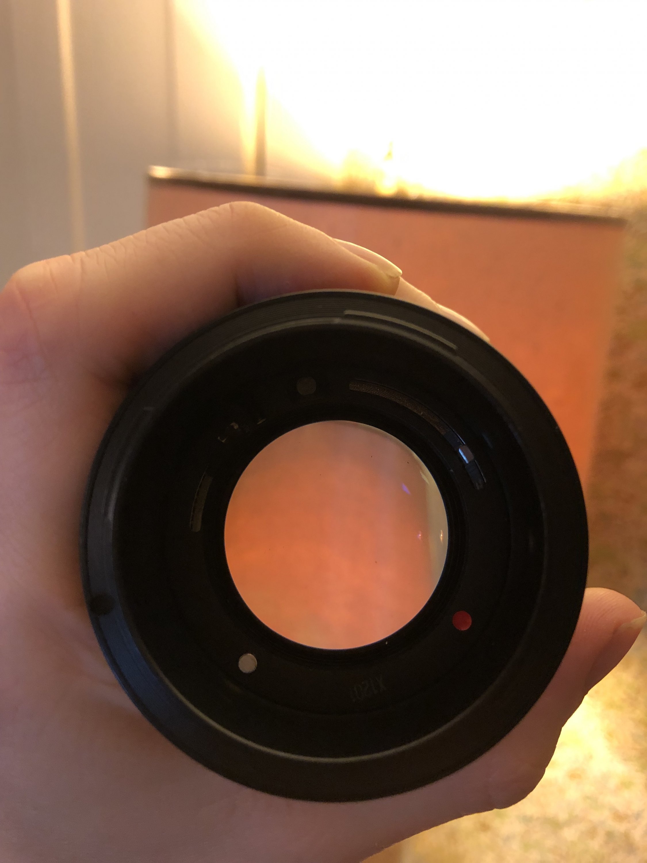

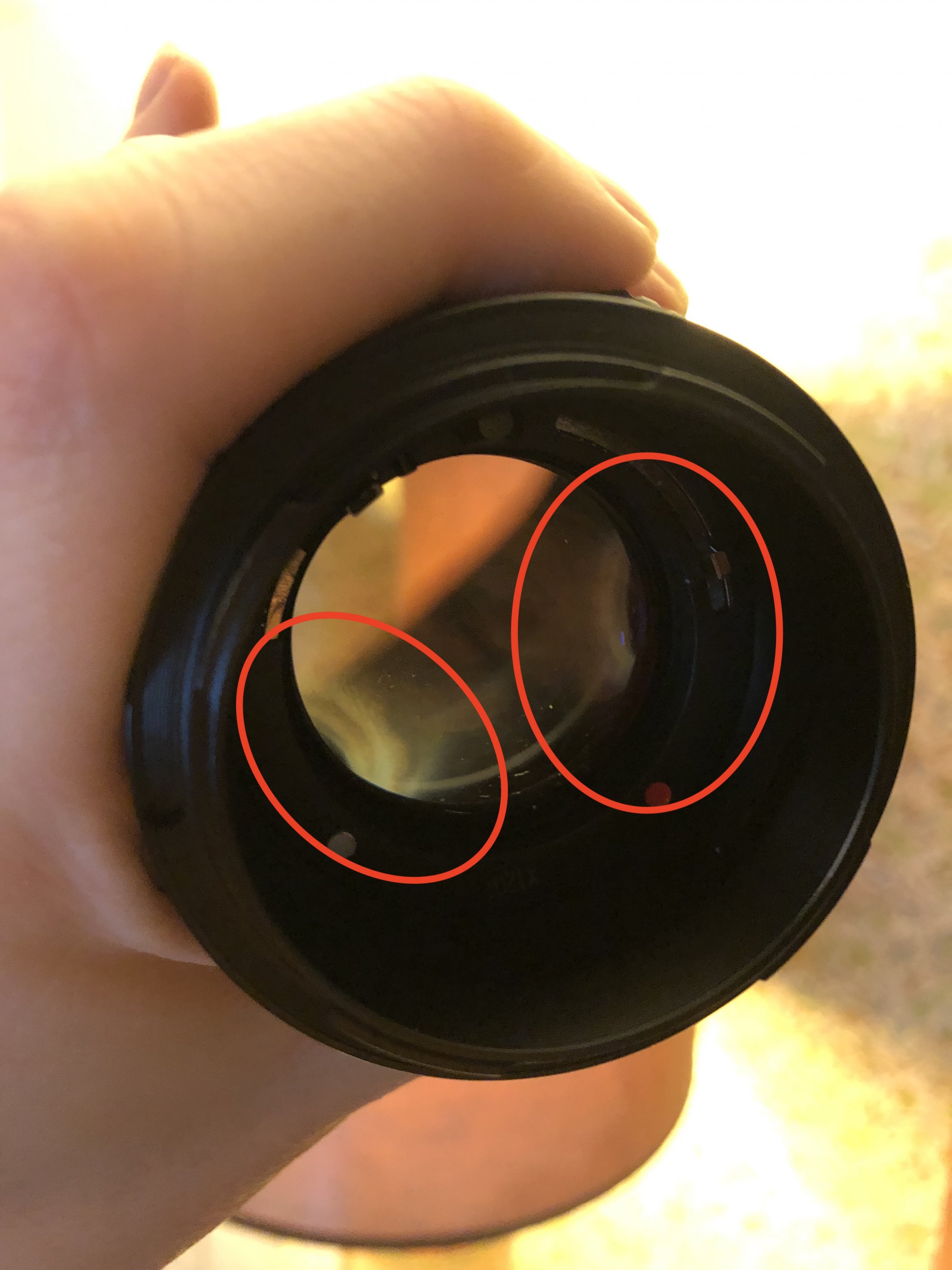

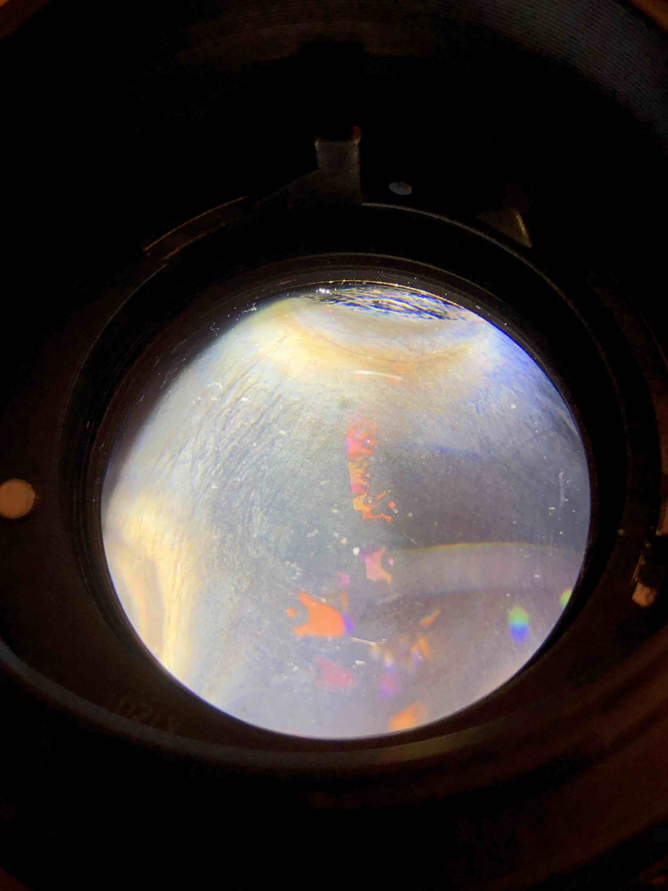

Bought a lens from a camera store described as EX condition but now noticing what seems to be pretty bad haze possibly right behind the aperture, in the rear of the lens.
Invisible to the eye normally, but very bright with a flashlight. Oddly centered around three equidistant points at the edges of the lens.
Is this haze that can be cleaned or decementing? Should I return it?

Pretty bad haze. The semicircles look almost like impact damage of some sort. It is possible to drop a lens
on a soft surface and still damage a lens element without damaging the barrel.
I don't think that's what it is. It's very odd, the circles seem to be evenly spaced at 120º from each other. It might be haze from the aperture? But it almost looks as if someone tried to clean it already.
What do you think it would cost to clean?
I'm returning it but curious what it is.
I had many lenes in my hand but never saw such circular structures. Looks as if some sort of corrosion spread from a point.
That hazy lens also looks to have some pretty severy cleaning marks -- scratches -- to me. I'd say it's toast.
