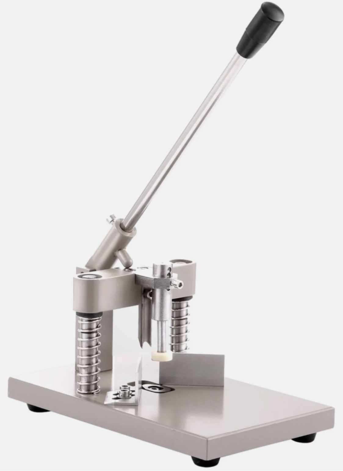

I use a giant corner rounder press to do it 10 sheets at a time, it’s awesome
