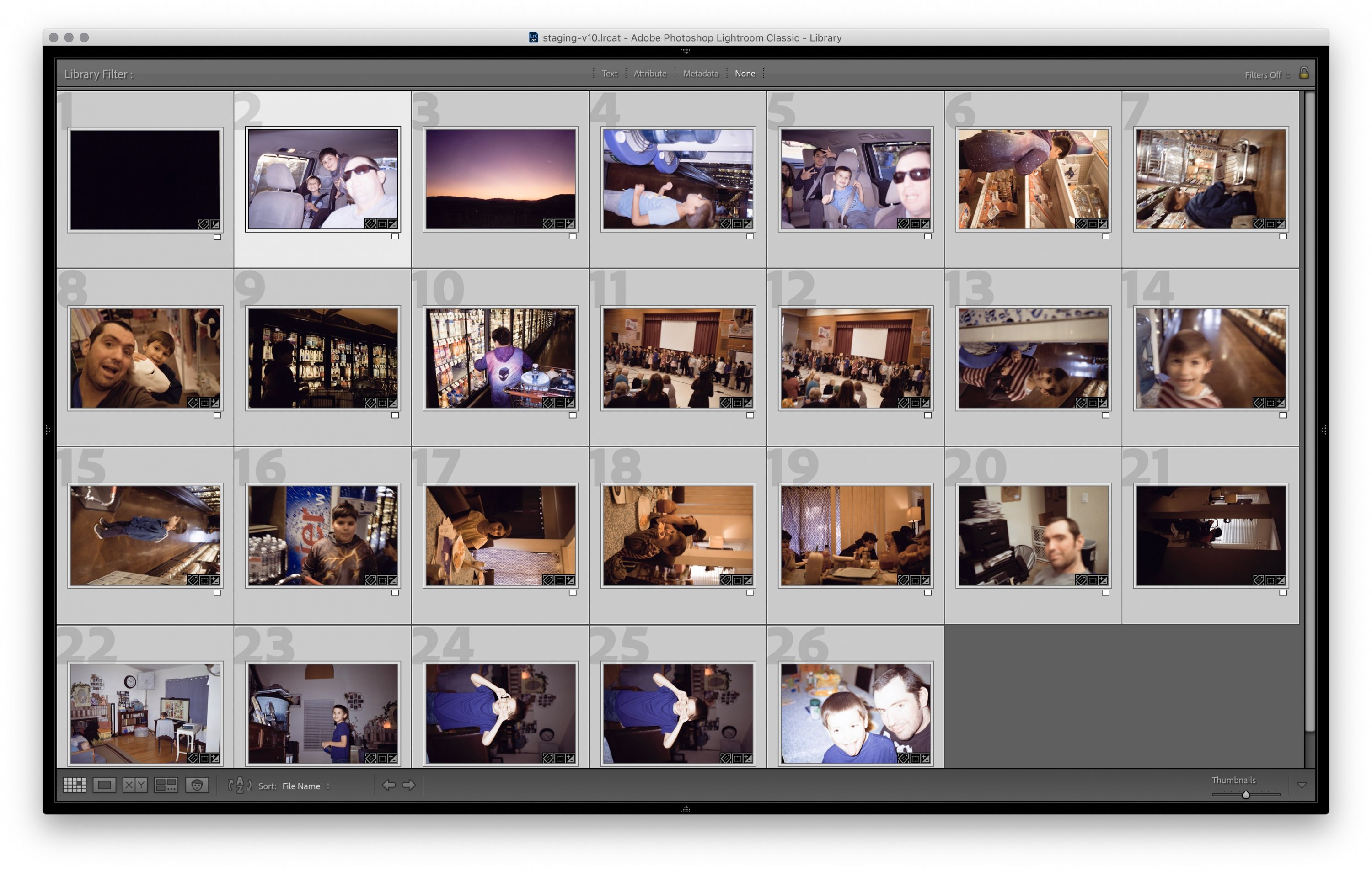

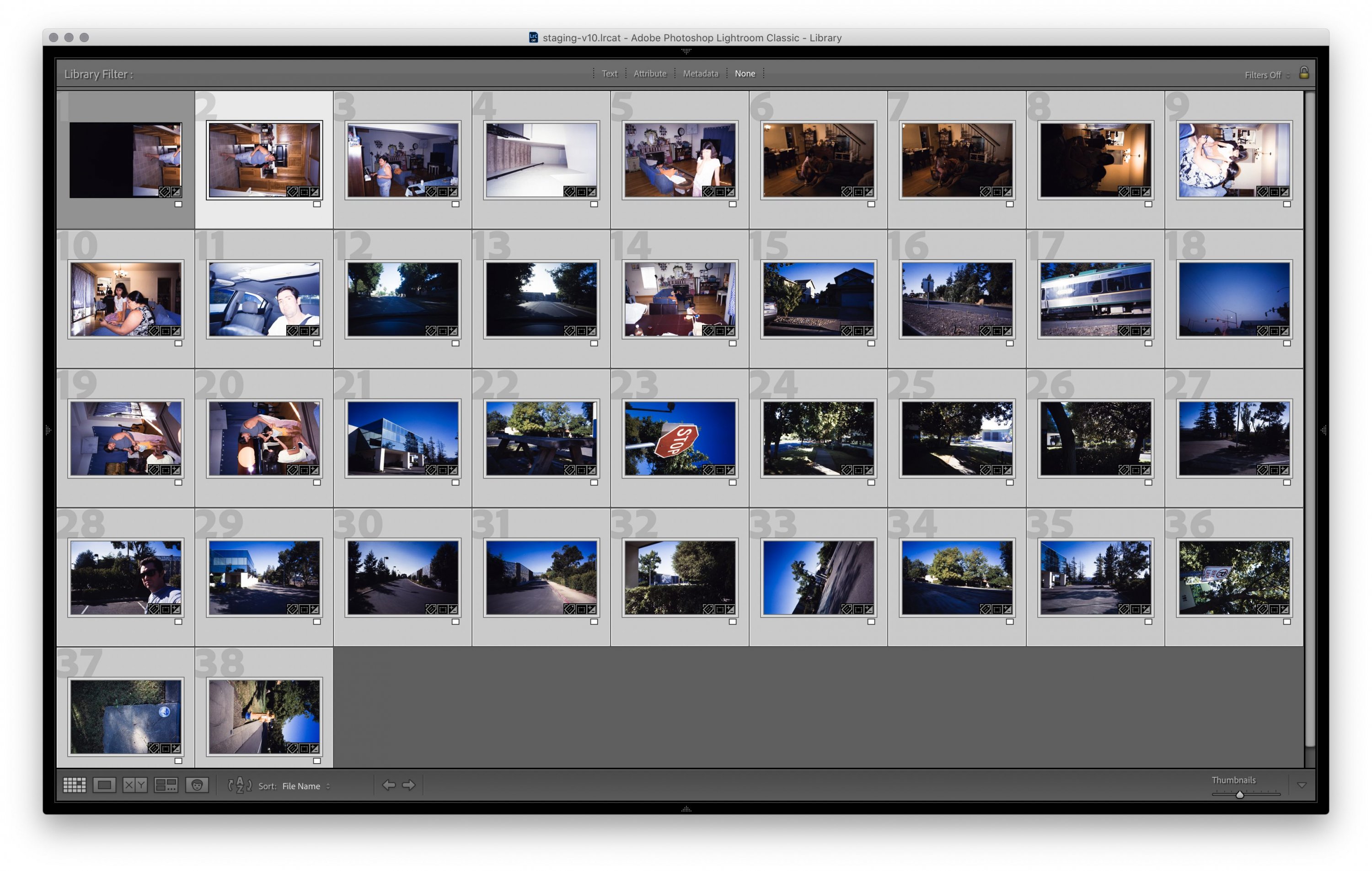

Well, here are two screen grabs of a roll of superia 400 xtra and gold 200. Both shot on a little crap point and shoot. This is straight out of my scanning software. My current hardware setup is a Canon 90D, Sigma 70mm macro art lens (the new one, not the old one), a strobe for the light source. Both rolls were shot in all kinds of mixed lighting with all kinds of different exposures, pretty representative of what comes through my lab pretty much every day.
The straight scan isn't a terrible place to start.
First, the Superia
Then the Gold 200

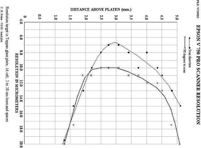

For a photography workshop at an university we're looking to upgrade some of our scanners. I'm struggling with finding the best solution and I hope you'll share your experiences with certrain methods of scanning.
Single problem of the V850 is that it requires attention from a good operator to get a top notch result.
As graph bellow shows, if you miss focus by a 1.5mm (curling) then you may get 1/3 of the line resolution and 1/9 of the area resolution. (See the case you go from 3mm to 1.5mm)
Additionally, a top notch Epson scan also requires a careful image optimization (in Photoshop or the like) not everyone is able to perform.
But those people being able to operate the V850 properly do obtain an amazing yield. If you want the students learn to squeeze all the performance an scanner may yield then retrofitting the V850 with BetterScaning holders would be a choice, specially for MF and up.
If you want the students get perfect scans directly, without asking, then the Epsons are a bad idea.
My personal experience is consistent with this review: https://petapixel.com/2017/05/01/16000-photo-scanner-vs-500-scanner/ , but YMMV
