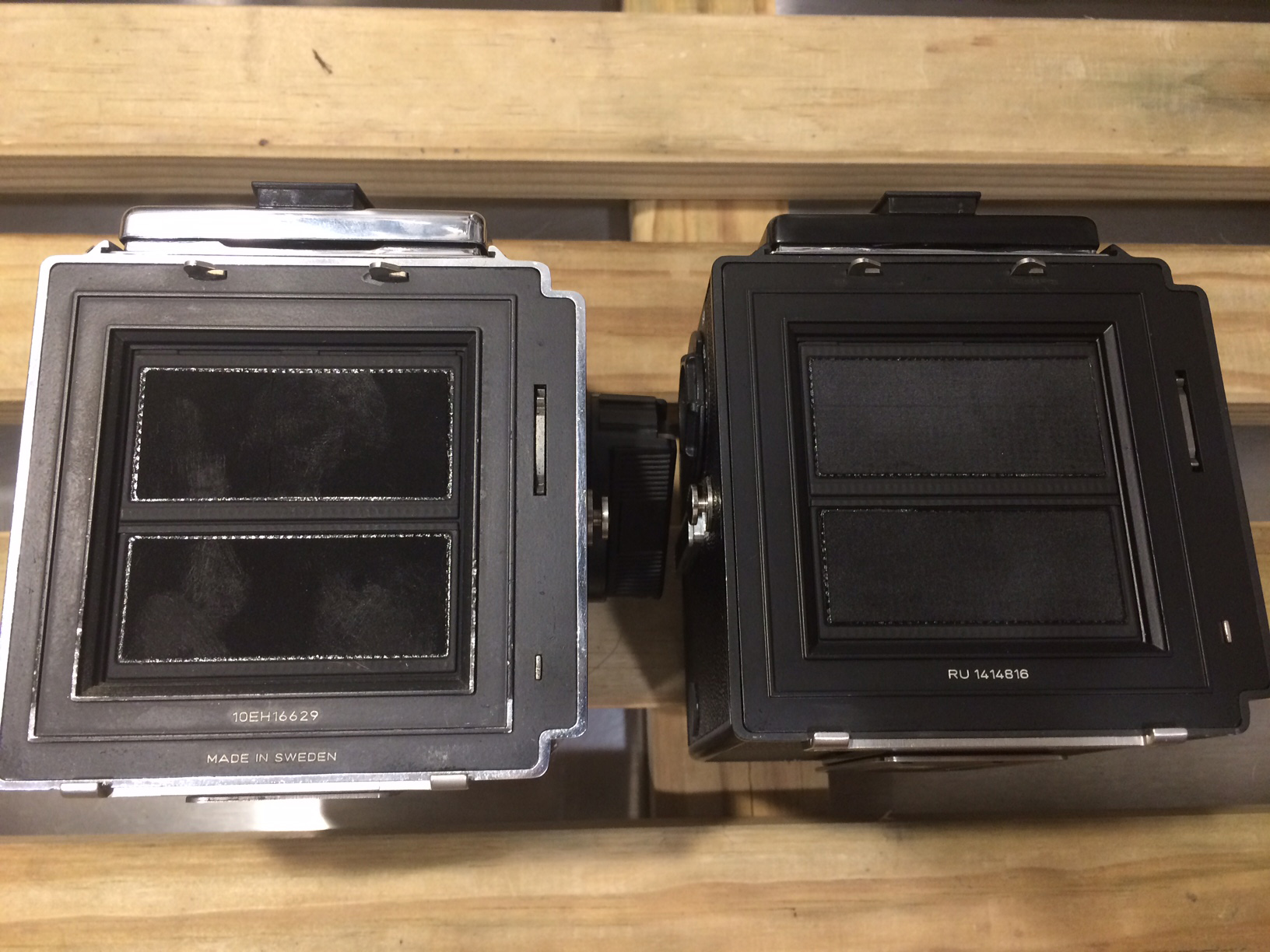

I have always wanted one and now I can't get it out of my head. I have been looking for one in my price range of $850 but most are more. What should I be checking if I do find one? Should I stay away from the 500C?
I'd try to find a clean 500 C/M with an A12 Magazine and an 80 CF lens. I'd stay away from the 500C due largely to age. See how beat up the camera back where the magazine attaches. The photo below, the left camera has had use, the one on the right is pristine. The ridges on the back get nicked by the magazine when attaching, this is normal when used professionally and you're attaching the magazine quickly. Not that a camera with heavier use will give trouble, just pay accordingly. I own six 500 C/M and one 503 as well as a SWC/M. Most of my lenses are C Compur lenses, some of the 80's are CF Prontors. There is nothing better than a Hasselblad; I used them professionally for some 25 years. It's a professionally designed camera and does require some service. Don't use the pre-release button on the side, and I doubt you'll experience a jam. Good luck!
