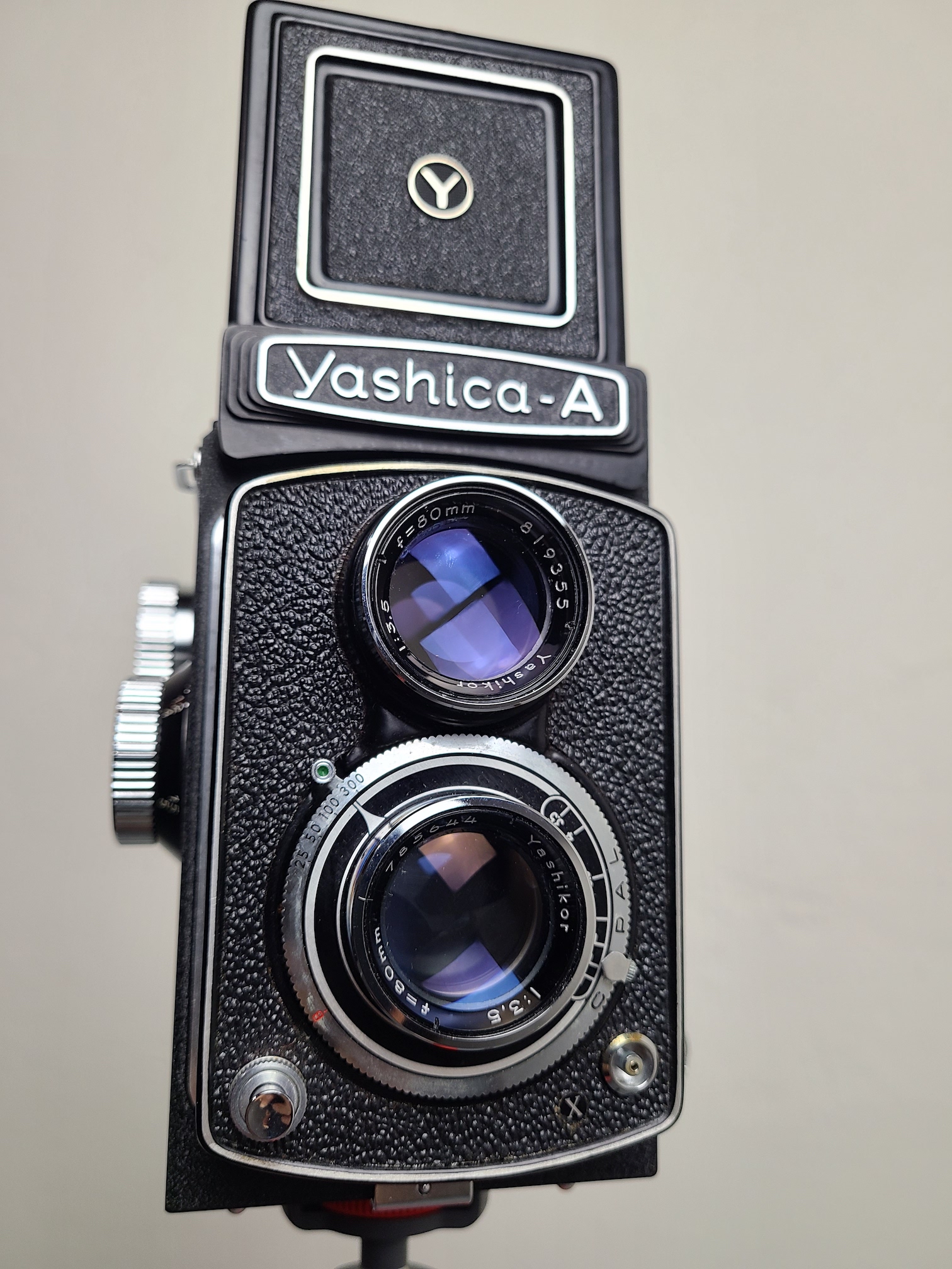

I was giving up on the auction site trying to find a camera, prices out fo control, cameras for parts for hundreds of dollars...thinking I'd be better off carrying my dslr...
until I found a little Yashica A: - “It’s in very good shape comes with leather case... Very good condition not sure if it works no film".
There was one picture of the leather case with the camera inside. That's it. I offered $50 and the seller accepted.
The camera arrived today and everything seems to work fine. Lens, mechanism and cosmetics are impeccable and there was a half way exposed roll of Kodacolor II which I don't know what to do with it. Should I get a C41 kit and develop? I only have b&w chemistry. Anyway, here is a picture of the camera. :D
I shot a lot of film in a Yashica. I made the mistake of storing it with the cable release installed. The cable release is one of the Nikon style the fits over the shutter button - in other words big and making a long lever. At some point pressure on the cable release levered the shutter button out of the camera body, which is thin metal. So, I’d advise never store the camera, or carry it in a bag, with the cable release attached.
Thank you for the info Juan. I was wondering where the shutter release connection was : ). The manual also mentions a self timer but I cannot find any around the web.
My vote if for Yashica A. Pretty light wait. Also, Ciroflex cameras are pretty light although I'm not that fond on the lens quality.
