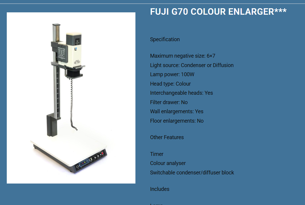

The Fujinon EX 6-element enlarging lenses are every bit as good. Unlike Minolta, Fuji never made enlargers -- as far as I know.
I beg to differ :smile:
I may be wrong, but I think that was made by Fujimoto -- which also made the E-LUCKY enlarger lenses. Although they rhyme, that's totally different from Fuji Photo -- which made the numerous Fujinon lines of enlarging lenses.
I don't know if the Fuji enlargers were available in the US.
That image is actually from a UK listing.
A friend in my Darkroom Group has one that complements his 4x5 enlarger(s). And he really likes using it.
It has some interesting features, IIRC.
As far as fit and finish, it reminds me of both the Durst M600 and M700 series, as well as my more recent LPL 7700 enlargers.
I've wondered whether the LPL enlargers share some history with them.
