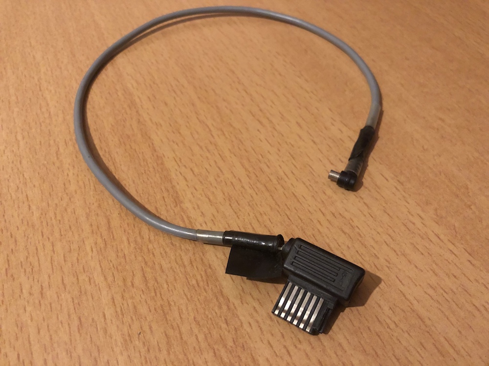

Thanks very much for helping with the connector on the Ares. I have a cable with PC plug to Metz-specific connector, see attached image. Are there such things as a PC (female)-RCA (male) adapter?

Thanks a lot - your reply made me wonder if there is a cable with the Metz-specific connector that ends in a hotshoe?
That Metz has no PC connector, but instead a Metz propriatery connector. One needs a Metz cable (or clone) from this connector to a hot foot or PC plug.
I think you might be right. I can only get TTL to work with the SCA 300A and SCA390 kit. But I wouldn't be using TTL with the Phottix triggers.
Just firing the flash is one thing. Using the Hasselblad's ttl is quite another. I am thinking that would have to be hard wired.

Thank you very much for the replies. And apologies that it took a while to write back; I was travelling and only returned home today to check more exactly what connectors I have for the Metz flash.

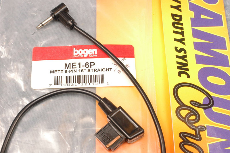

Here is exactly what you need:
https://www.bhphotovideo.com/c/product/685440-REG/Paramount_17PWME16P_PW_ME1_6P_Metz_6_to.html

Hi again Scott
Would you know if this cable would work? It only has one lead on the flash end. I wouldn't use this cable for TTL through the SCA but to connect the flash to the trigger. But perhaps all leads are necessary for that?

Hi again Scott
Philip
That SHOULD work for just triggering the flash. Obviously no TTL, but as you've said, in this case that's not the goal. I've not seen a Metz connector before without multiple pins, but my experience is far from universal.

For triggering a SCA flash that can be set to manual- or auto-mode just a 2-pole connection is necessary (of course it must be the right poles...).
