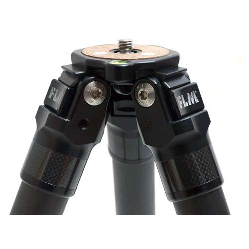

If it helps, I currently have an FLM CP30-L4 II tripod.

I checked out the FLM CP30-L4 II. It seems like a good sturdy tripod and it does't have a center column, a good thing for you. However, it does seem a little small (not short, it's quite tall). A beefier tripod might be needed. Having said that, with your budget constraints I might look at Leofoto's offerings. They rip off just about every high-end design and sell for a lot less--it seems they are constantly having a sale. The quality is good, just not as good as the originals they copy.

My FLM tripod doesn't have a center column. I picked it specifically because of the issue you mentioned!
That's a nice tripod for 35mm and some lightweight TLRs, but its not sturdy enough for your camera system.

I did look up the FLM tripod in question. The specs say it's rated at 44 lbs capacity. Guess so, if you factor in an 800% BS coefficient. Those kinds of alleged weight ratings mean that if you put 45 lbs atop it, it collapses. But far less might make it wobbly or shaky. Again, think real world torque vectors, which increase with longer heavier lenses.

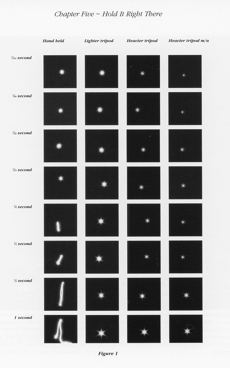

The late Barry Thornton published this test in his book, Edge of Darkness. It was done with a 35mm SLR and normal lens. Just imagine with a monster like the Pentax67 and a long lens.
Try real stars on a research level. If the P67 had a sloppy "spring" issue between the lens and body, do you think comet and asteroid hunters would have adopted that system? The demand for precision was so high that they even customized these 6x7 bodies with vacuum backs laying 220 film dead flat, with no intervening paper flatness issues. Now most have switched over to MF digital cameras instead, but that wouldn't alleviate any lens mount issues. Thankfully, that kind of problem never did exist. But the kinds of astronomical mounts they use can easily run up to $40,000 dollars or more, not to mention dedicated mini-observatories. Not a cheap hobby. Evidently, the astro photo forums consistently have a much higher opinion of the P67 system than some people of this forum have. It was also a well-regarded aerial photo camera.
Great book, focused on getting maximum sharpness from your pictures. This includes enlarger negative carriers and lenses. Get a copy if you can.
