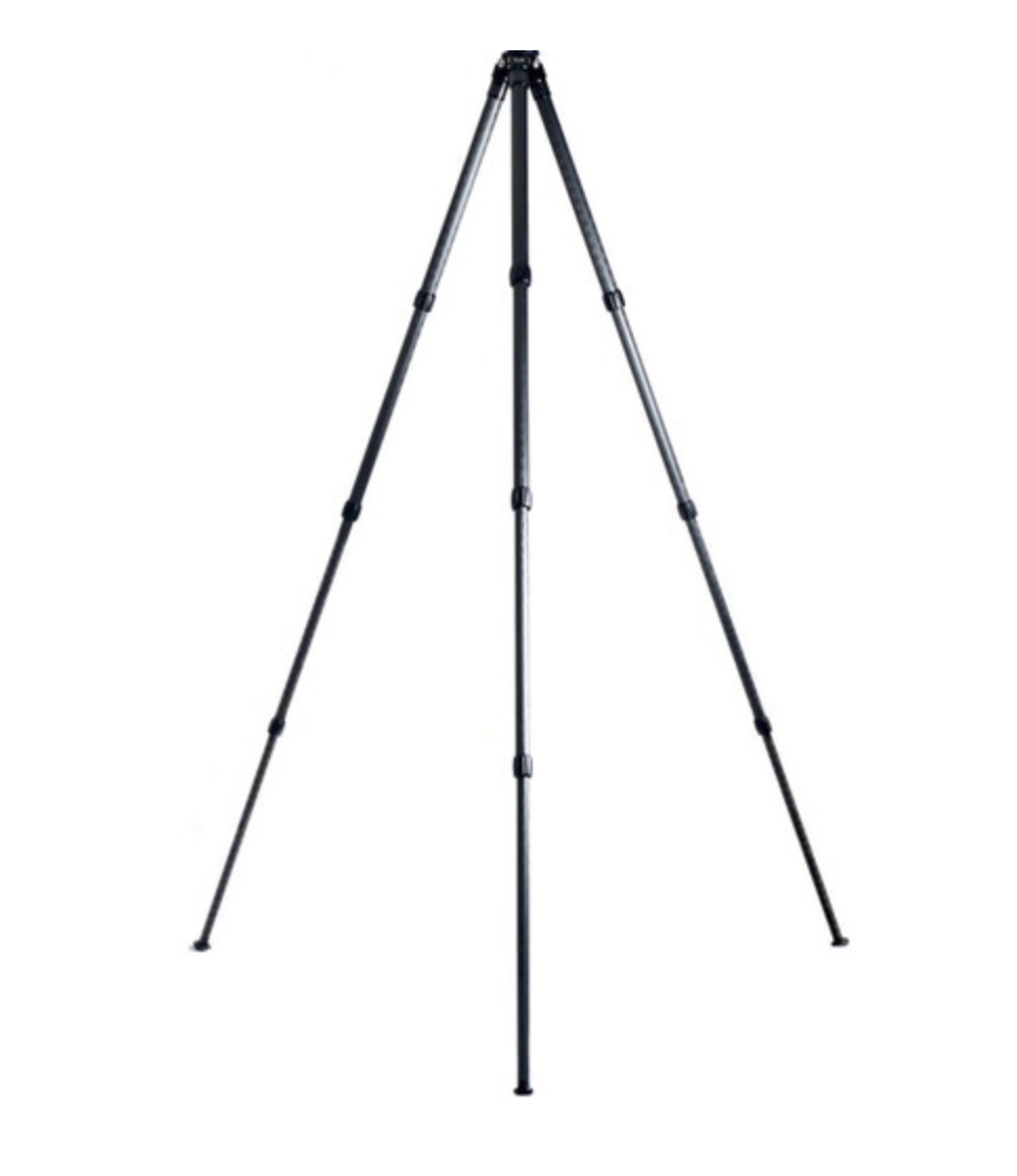

The OP's tripod does not have a center column, but it looks a little spindly to me.

Before I replaced it I spent a little time in B&H swinging on all of their floor model tripods. Most lacked torsional stiffness. I now use wood tripods -- an aged Ries and a decent grade of Berlebach -- that are more than stiff enough. I hate using ball heads, use hefty Manfrotto 3 axis heads instead, mounted on Manfrotto levelers so that should I pan to get a somewhat different shot the horizon won't move. I may still have to adjust tilt, but this is less work than adjusting tilt and roll.
I'm astonished that the OP thinks the FLM CP30-L4 II is stiff enough. No B&H floor model with similar leg locks passed my informal test.

My FLM CP30-L4 II (no center column, see photo attached below) tripod is light, for sure, at 3.1lbs, however, underneath the head there's an attachment for an S-clip to attach a sandbag, which I should consider. Also, after noticing the top rated ball head at the TheCenterColumn.com is the Feisol CB-70D, it prompted my search for 70mm ball heads, as generally speaking, the larger the ball, the steadier/stiffer the tripod head. After searching around for a bit, I'm wondering if the Leofoto HB-70 70mm Pro ball head would work. Do you guys think that this Leofoto HB-70 ball head would suffice, or would that be like taking a tank to a gun fight? (Photo attached below.)

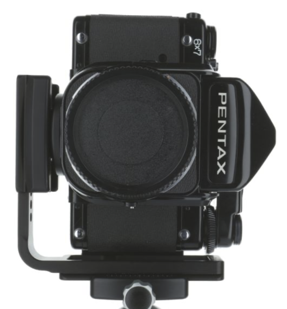

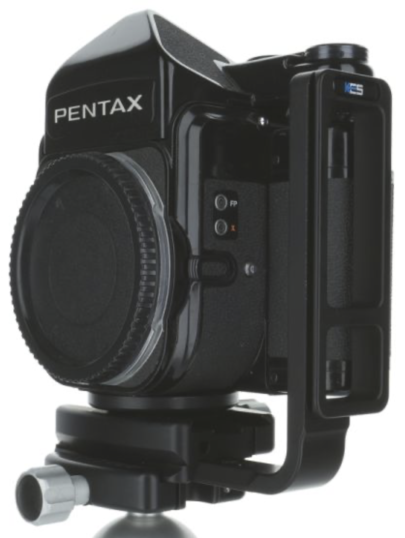

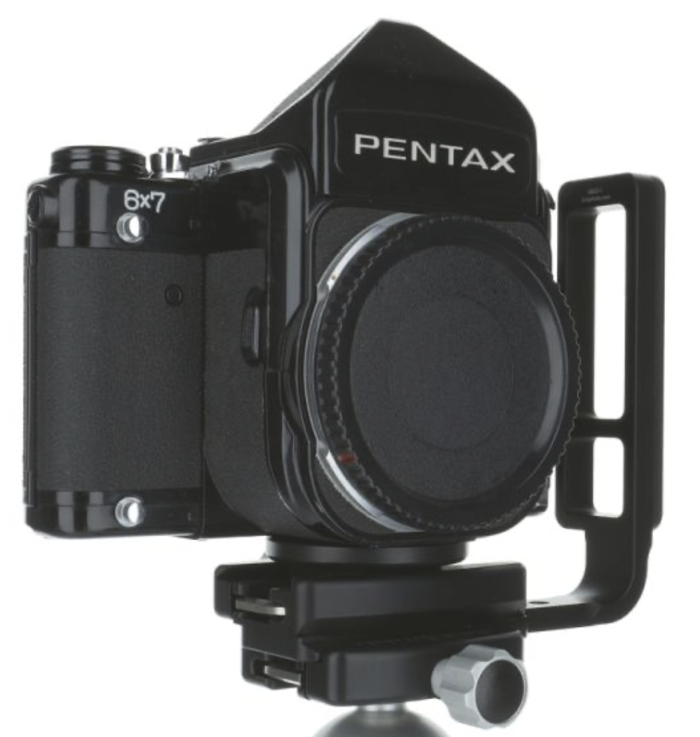

Also, I almost forgot. I use a "Universal Quick Release Tall L-bracket for the Pentax 67II" from Kirk Enterprise Solutions. When I flip the Pentax 67II with a 200mm lens to portrait orientation using the Kirk Universal L-bracket for P67II on my Benro GD3WH 3-Way Geared Head, that's when I notice the most camera shake. Kirk used to make a dedicated non-universal L-bracket for the Pentax 67II, but these days it's just a unicorn that sometimes pops up on eBay for $800, which is just obscene. Anyway, since there are 3 different pieces/components of the Universal Quick Release Tall L-bracket for the Pentax 67II, it feels like it makes for an unsteady system. I found someone on Etsy who makes a one-piece L-bracket for the Pentax 67, and it being only one piece (instead of Kirk's 3-piece one), I suspect that it might make for a more stable shooting system. (See attached photos of Kirk's Universal L-bracket for the Pentax 67II vs. the one-piece Pentax 67 L-bracket made by someone on Etsy.)
Kirk Universal Quick Release Tall L-bracket for the Pentax 67II--

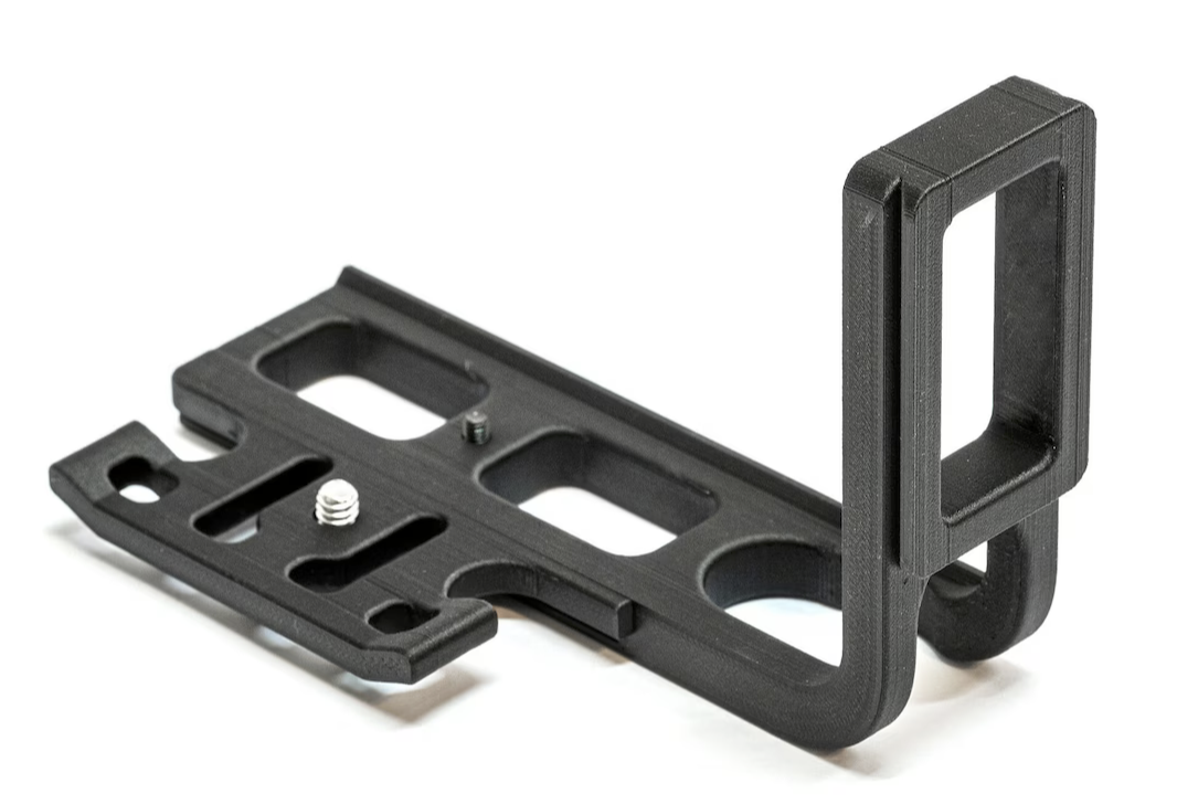

Etsy Pentax 67 L-bracket--
