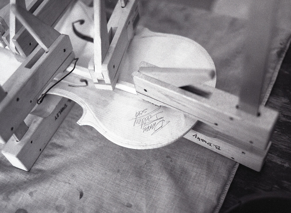

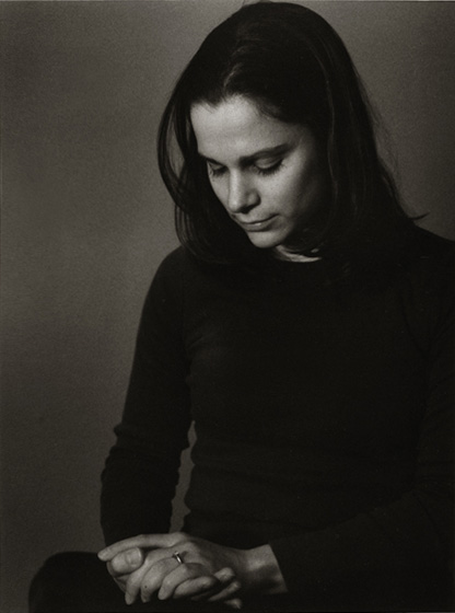

Here are a couple of shots showing 645 format and Rodinal with different films.
The first shot Gluing the bassbar is Delta 400 shot @ 400 in rodinal 1+50, 18 min
the second shot Red Shoes is Neopan 400 @ 400 in Rodinal 1+50 , 11 min
and the third Little Girl playing fiddle is Tri-X 320 at 400 in Rodinal 1+50, for ?
What your minds eyes sees for "Grainy" only you know.
Also lighting conditions will have an effect on grain.
Hope this helps a bit

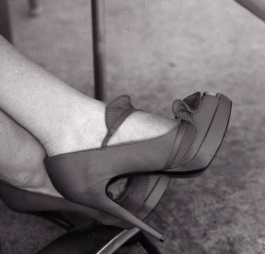

Here's a print from 120 format 645 Delta 3200, processed in Ilfotec DD-X. It isn't very grainy at all. Rodinal would give you a bit more grain, but not that much more.
I would strongly recommend shooting 35mm anyway as that gives you more choice. The grain from Delta 3200 in 35mm is fantastic, and I agree that the grain from Ilford SFX in Rodinal is stunning.
Foma 400 is another good candidate, a film I've used a lot. It's strange, because with fine grain developers like Edwal 12 or Xtol, I get next to no grain in an 8x10. You have to get really close to see it. But in Rodinal it really blossoms and you get this gorgeous sharp grain that looks wonderful in a print.

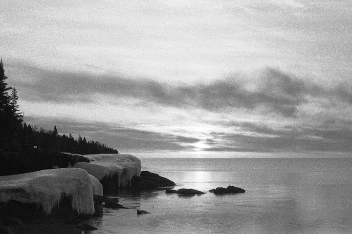

This is what Delta 3200 looks like in Rodinal 1+25 (shot at 1600). It's a neg scan, and my scanner can't fully resolve grain, so it will look grainier than a print would. But it gives you some idea of what to expect from the film. This is almost a full frame with very little cropping.
- Thomas
