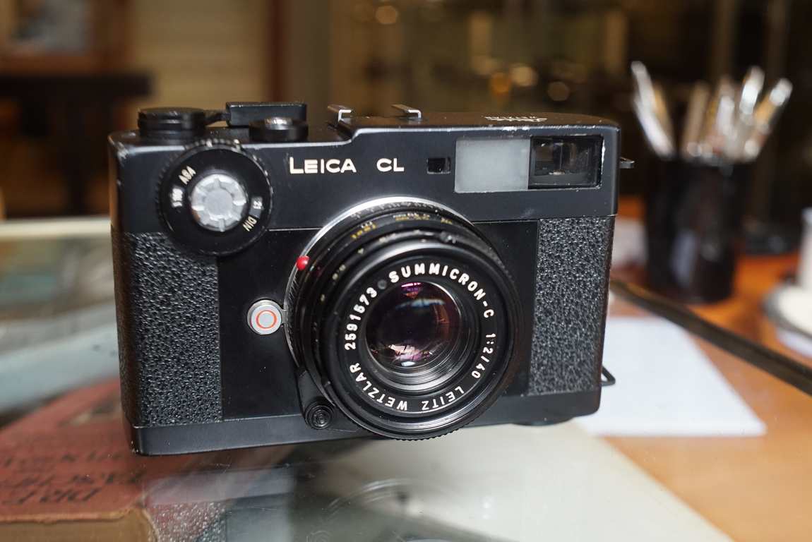

You wanted a CL or CLE, and I send you a link for a nice deal.
