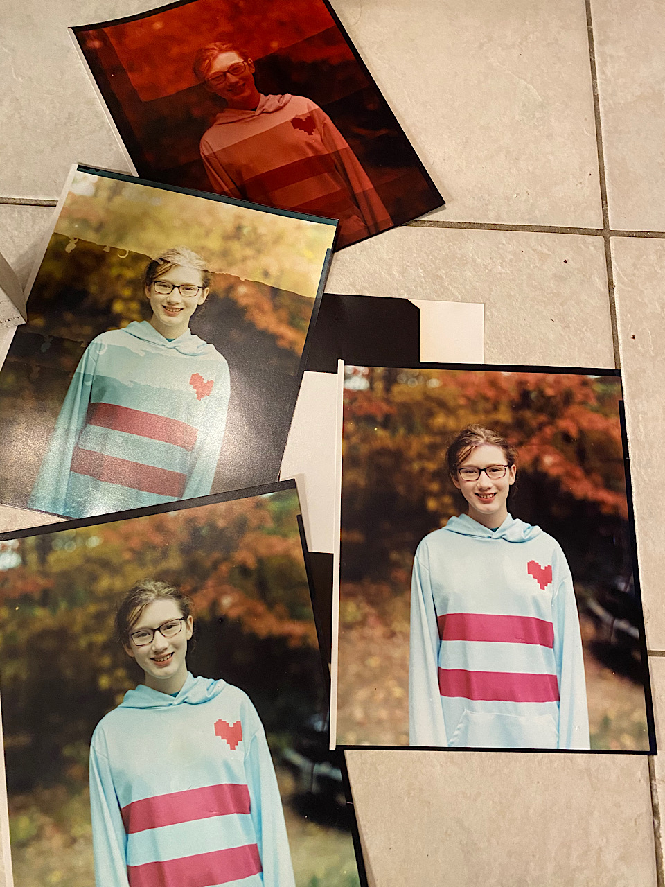

The Arista C41 kit is great. This is an RA-4 contact print off an 8x10 Portra sheet developed in the Arista C-41 kit, after the chems had been stored for a month or so
