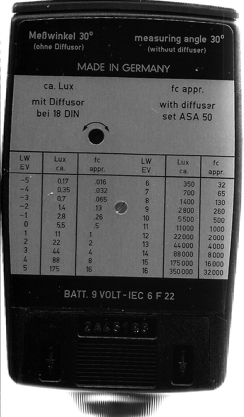

Make yourself a spread sheet.
Here's the Gossen conversion on the back of my Profisix SBC
attachment.php
This ones for 50 ISO EV6 is 1 second @ f8
Ian

wiltw
Oct 4, 2008
6,615
SF Bay area
Bear in mind that EV is not a measurement of light, it's a combination of shutter speed and aperture. It only represents a light measurement when the ISO value is included.
Steve.
Yet if you look at the various equivalents at EV0:
  • Sekonic at ISO 100: 250 lux, 0.23 foot-candles
  • Gossen at ISO 50: 5.5 lux, 0.5 foot-candles
  • Minolta at ISO 100: (lux not specified), 0.31 foot-candles
...I see no agreement in the above three equivalents!

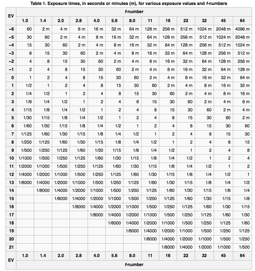

chriscrawfordphoto
Mar 12, 2007
1,893
Fort Wayne, Indiana, USA
This represents differences in the calibration standards each manufacturer uses.
