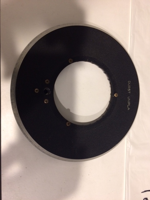

Post a photo of the underside of the underside of the the lens stage, where the turret would go. The last photo you posted is a a plain turret, which you can use to mount up to 3 lenses on Lapla boards. I have no experience with the motorized turret, you can probably sell it if you don't use it. I prefer the Unipla instead of the turret which mounts a single lens since it has less moving parts (none) and is easier to align. You should be able to pick one up used at auction. Once you buy a lens, I'd send it to SKG and have him make you a custom Lapla board to go on the Unipla or Turret, or if you want, I can send you a plain Unipla board which I'll never use and he can mount it on that. It has a 3 5/8" hole, but he can make a plate to cover and have the len's threads cut in the right size hole. The lens would then screw into the Unipla. This is probably a cheaper machining job than having a Custom Lapla made for the 240! If you're only going to use 1 "large" lens, that may be an option and you can mount smaller lenses on the turret each on their own Lapla board. I buy Laplas at auction when they're cheap and then send them to SKG with a lens if the Lapla's threads are different from the lens and he can cut new threads on the Lapla. You can now pick up a couple more Lapla's when they're cheap. Just make sure they're Laplas since some of the smaller ones (Sixpla, etc) won't fit the Unipla/Turret because the ouside diameter is too small. Recessed laplas are called Setoplas. A 2839 Setopla has a a 28 mm recess and 39 mm threads. You can use those on the Unipla for lenes that need a small recessed board, but on the turret, the turret probably won't turn because the board will stick out too far. You'll have to mount the Setopla on the hole in the turret that's at the front. This will make more sense when you get the turret in hand.

this is the underside of the lens stage, I believe it's a common lens stage as all Durst 184 :
I will ask the seller, if he don't know how to do, I gonna sell this motorized focusing system.
I'm still looking for my 240mm lens, I'm waiting some responses.
I think I'm gonna use one large lens mounted on an Unipla, if SKG can cut the lens's threads directly without custom Lapla, it'll be perfect.
Once I'll have my lens, I'll tell you. Your offer will be welcome
Maybe I will use the turret for small lenses, in case I use this enlarger for 4x5 or less, but I have a very good De Vere 504, will see

Good, 16x20 is plenty large for me and usually smaller. I don't even like to print that large because my darkroom is not that big and my 6' sink limits me to 3 16x20 trays. It's much easier to print 11x14! You can go up to 40x50 on your current enlarger with a 240mm lens. Don't be in a hurry on the lens, I sold one last year for around $100, and I bought a really clean one for $80.00 at auction. Sometimes people want to give themselves so many options that they will never use that they option themselves into obsolescence.

8x10 Format
