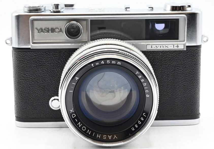

That one is a beast! How about a Lynx 5000 or 5000E? Smaller and lighter and a 1.8 lens.
