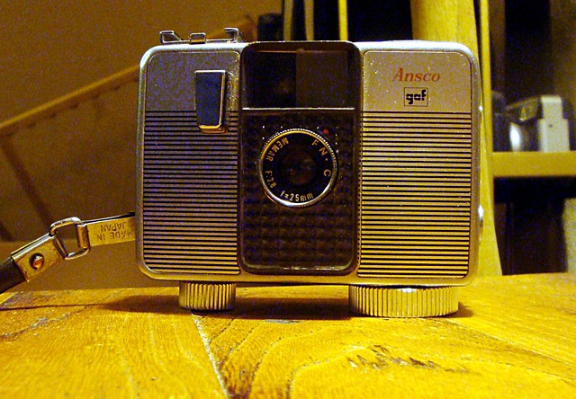

Ricoh Auto Half/Ansco Memo II Automatic are nice if you can find a working example. Auto-exposure or manual aperture control, spring loaded autowind, and very cool looking.
Ansco (GAF) Memo II by Greyscale3, on Flickr
