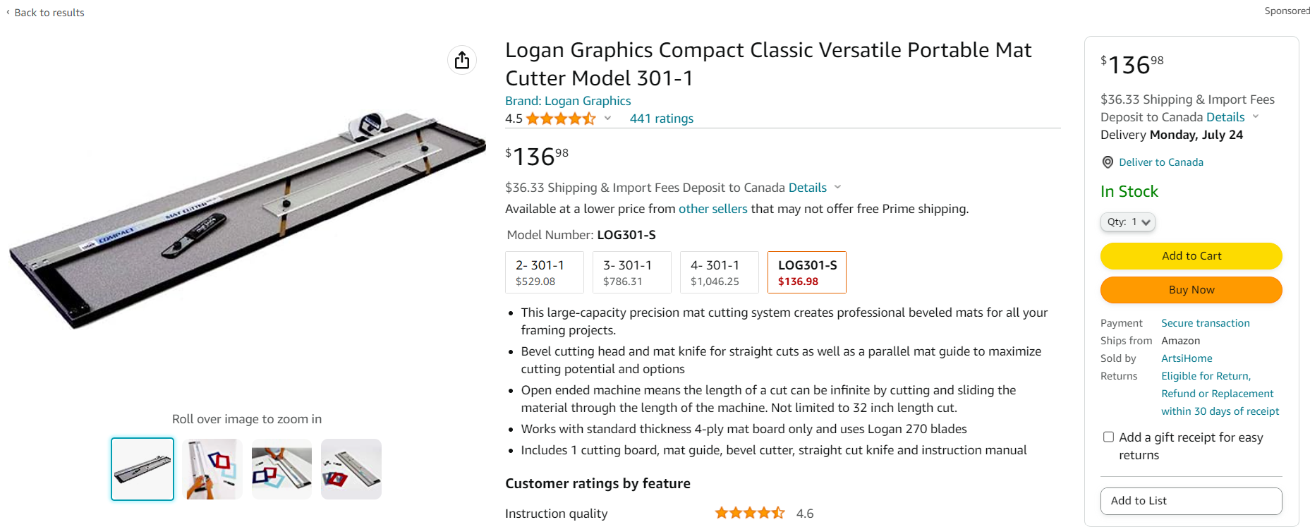

Mat cutters are what you use to cut those window mats that people put into frames for displaying prints.
One of these (courtesy of Amazon)
Many/most of us who prepare prints for framing and/or exhibition have them.
Cholentpot
Cholentpot
Oct 26, 2015
7,036
Thanks. Is there a version that is under $50? $136 is nice but it's a mono tool. I'd be using it for one thing.

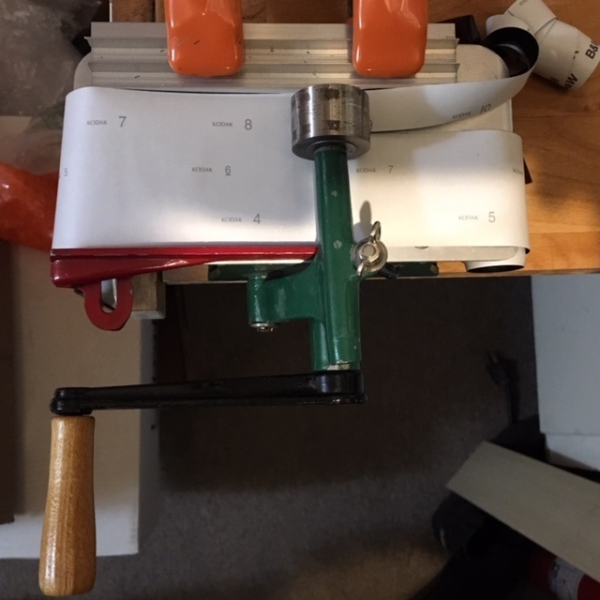

I use this old ribbon cutter that my mother had to cut down backing paper. Then I just mark the frame numbers with a marker pen.
Interesting contraption.
oh my god I need this for slitting 70mm/5” film into 120/220! What is it called, and do they still make it?

I have emailed them several times asking about backing paper, never got a response. Can you let me know what you did to get a response?
I'd also like to know what this thing is called exactly. Looks very useful.
BAC1967
Oct 30, 2014
1,456
Bothell, WA
I doubt they still make it, I think my mother bought it about 40 or 50 years ago. I have it stashed away somewhere, I’ll try to find it to see if there’s any markings on it.
