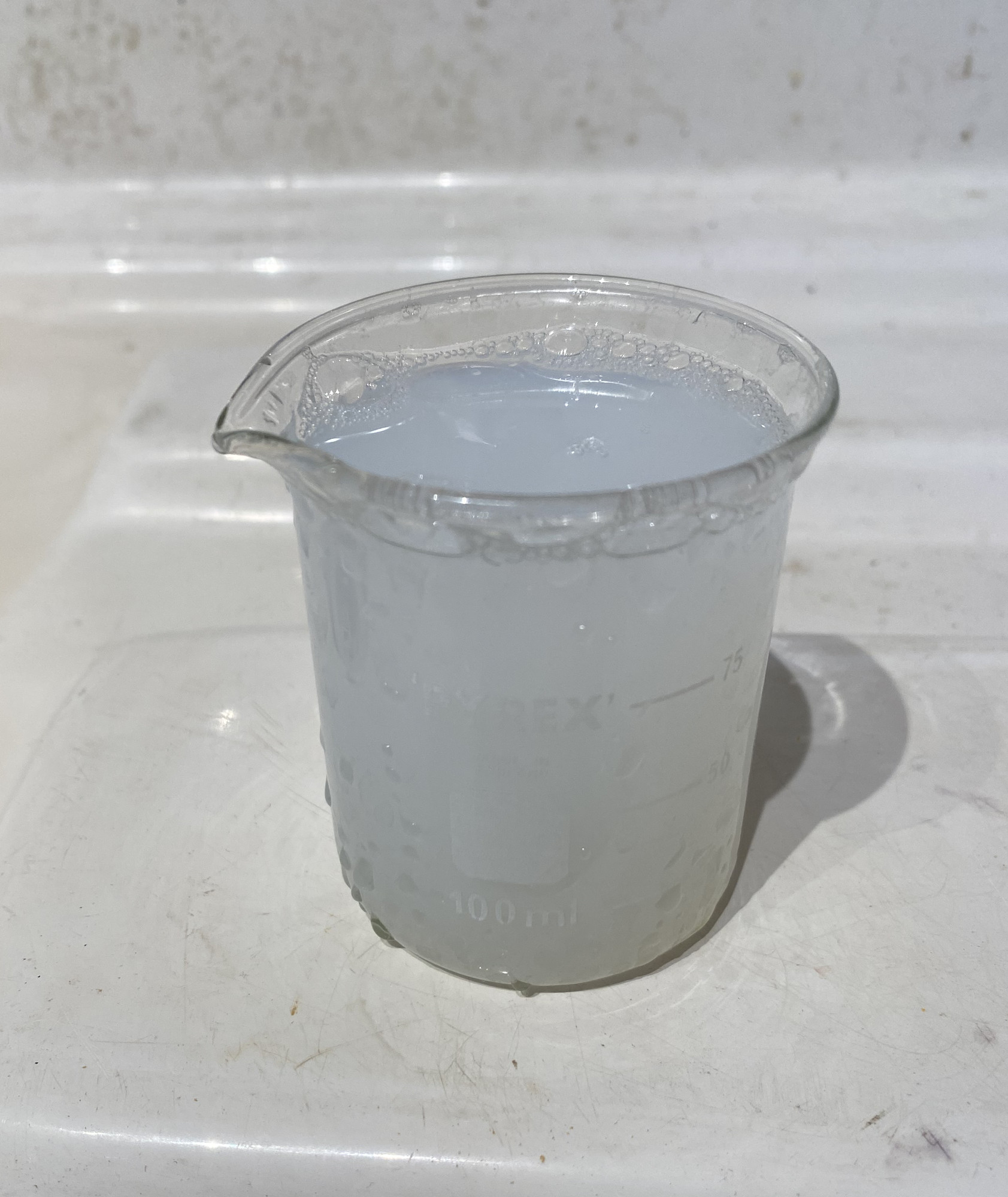

I have recently been working my way through an older bottle of Tetenal Mirasol wetting agent and have noticed that effectiveness of the working solution (1+400) seems to have declined compared to newer and / or freshly opened stock. As I usually simply work my way through a new bottle of wetting agent I've not really seen this behaviour before, and so perhaps some notion of a 'best-before' date should be applied to older stock.

Thanks for relating your experience. Looking at the old Mirasol in a pyrex beaker, the solution concentrate has a distinctly milky appearance compared to fresh solution which is completely clear.
