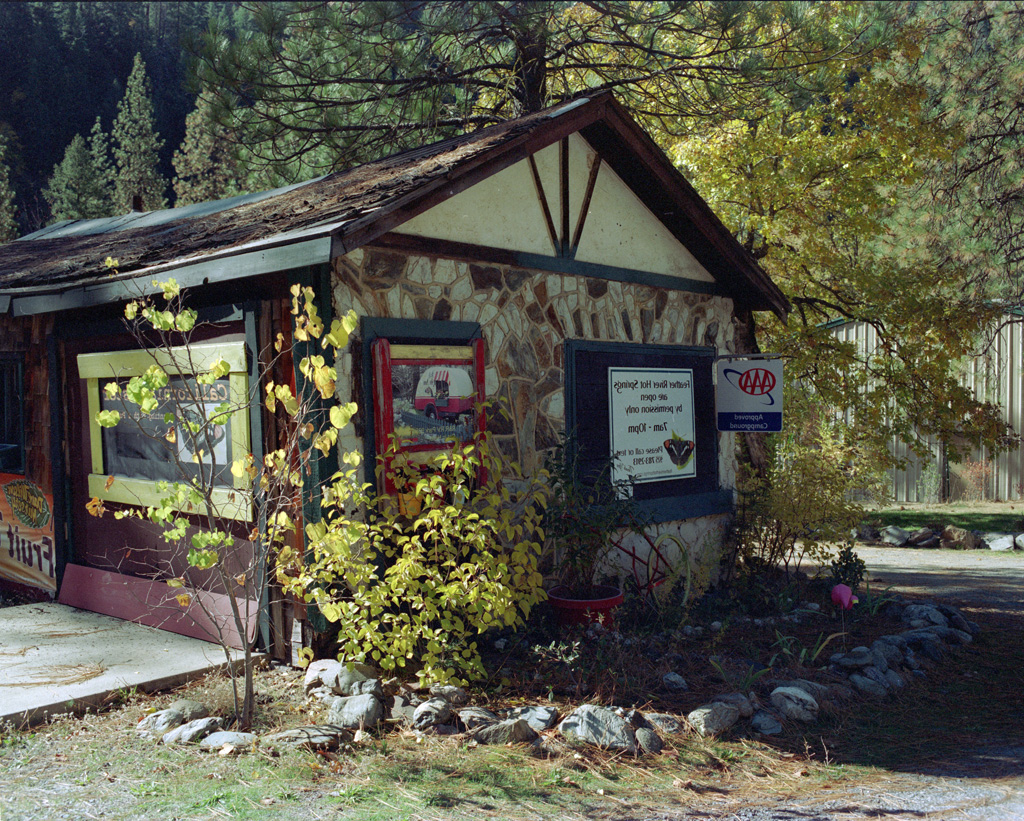

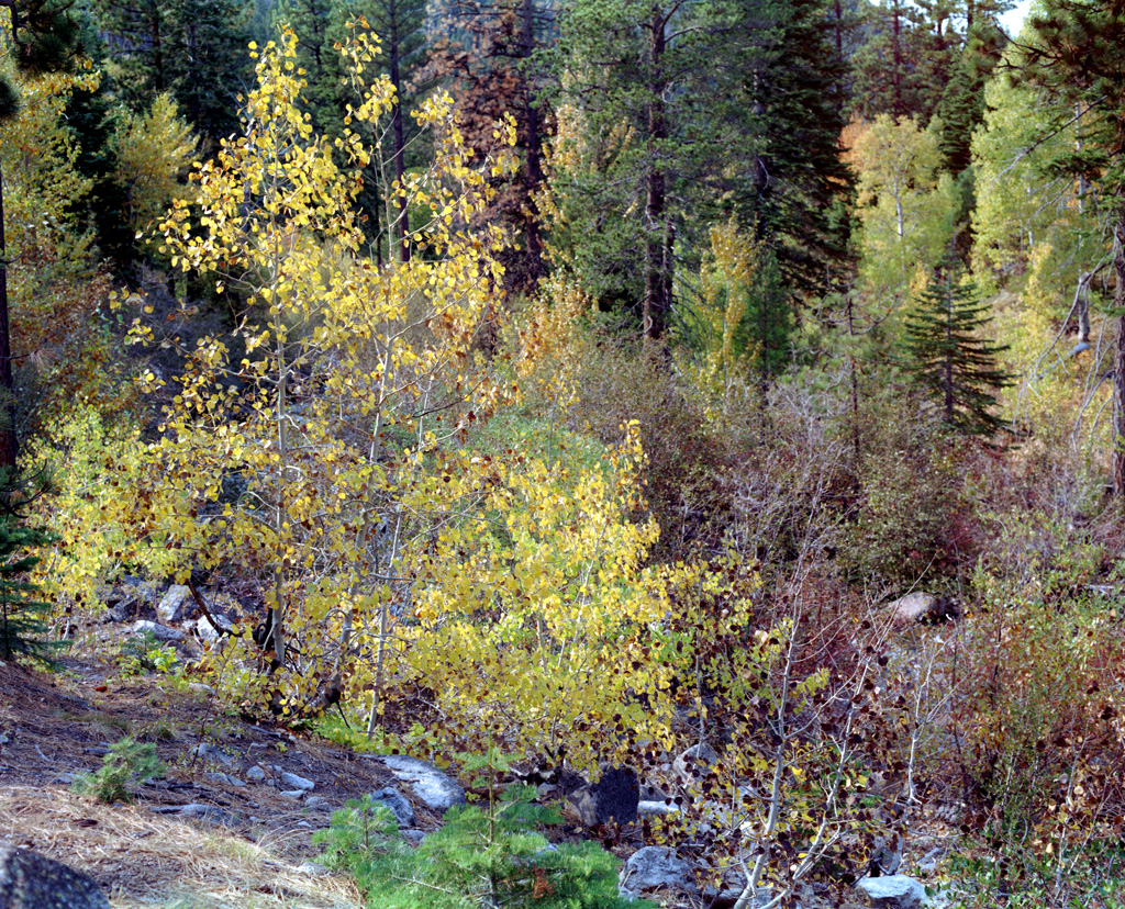

I just developed some films and would like to share a few pics for the purpose of validation of the trick I played to the C-41 process. It's understandable there are questions or even doubts if the trick is a worthy one. So please examine these pics as if you had paid big bugs and you would want them perfect. You will of course find issues. I would like to hear about them which will sort of validating the C-41 trick. By the way I did the trick mainly for saving money from using large sized developer replenisher knowing part C will go bad. Yes if I buy 5L kit I most likely won't need to play the trick. There have been questions raised by experts that sharpness of the film and color cross over might exist which would invalidate the usefulness of the trick. I hope the pics I upload here give everyone a chance to evaluate. Your critics and comments will be appreciated.
The films I developed and scanned are a roll of Kodak 400UC and a roll of Konica VX-100 shot with my Pentax 67 ii about a year and a half ago. The films were expired about 20 years ago but have been cold stored all these years in my freezer. The developer LORR replenisher was also purchased 20 years ago. The part C is of course not used and 5 grams of CD-4 is used instead. The CD-4 was also bought 20 years or so ago.
These pics are raw scan files with minimum density, especially middle tone brightness, adjustment only. No color adjustment or enhancement was done. This is to see if the process does cause color cross over and if sharpness is compromised. Well, I should not have done it with such long expired films. So here comes the pics.
The first two pics are from a 220 roll of Kodak 400UC. The other two are of Konica VX-100 120 roll. I really like the Konica Vx-100. It's very vibrant and contrasty and fine grain. It's long gone of course and probably nobody has it still. I still have a few rolls in my freezer.
No sharpening was ever applied to any of the pics. The scanner is a Minolta Dimage Multi scanned at 1180 dpi.
Densities look fine in general, even shadows of second photo are too raised on post.
One important thing and helpful about C-41 is that it always delivers something. You have to do some very, very catastrophic errors to end with something unsuable.
Scans don't tell anything useful about the presence of crossover or color balance. There's too much hocus-pocus going on in the scanner and its driver & software itself to be sure that what you get accurately represents the dye densities as they are present on the film.
Having said that, I see a lot of very nasty color casts, gross underexposure or underdevelopment in frame #2, what looks like a distinct color crossover issue in #3 and in #4 as well.
All considered I wouldn't be happy with these results if they were mine. However, as I said, scanning doesn't tell us much. Maybe the negatives print just fine onto RA4. I doubt it, but it's possible.
