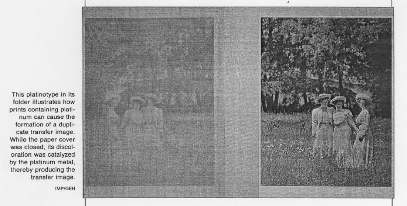

Hi all,
Now I have no doubt that almost any Pt/Pd print will easily outlast any untoned silver gelatine print, but one thing kept nagging me...
It is a not much discussed topic here on APUG, almost seems to be avoided, but I already knew Platinum (and probably Palladium as well), is a rather strong and effective catalyst, speeding up and enabling chemical reactions. One of the reasons it is used in car's exhausts.
Now I had already seen and partly read James M. Reilly's
“Care and Identification of 19th Century Photographic Prints”
document showing a Pt/Pd print been in contact with another paper, leaving a visible "mirror" image on the other paper by it's catalytic activity. See the attached image in this post. This is not just a "harmless" discolouring of the paper though... as I now recently read an article by Mike Ware about his Gold based Chrysotype process, referring to "embrittlement" of the paper base of Pt/Pd prints. While the highly noble and stable metals themselves will last indefinitely, the paper base and photographic image itself might be lost at some point...
Chrysotype: Photography in Nanoparticle Gold
Mike Ware literally writes in this document:
"It has already been stated that chrysotype resembles the better-known, and at one time widely acclaimed, platinotype process (38). New chrysotypes are extremely light-fast and resistant to chemical attack; they therefore enjoy an archival permanence at least equalling, and perhaps surpassing, that of the platinotype. The conservatorial problem which has beset all historic platinotypes arises from the high catalytic activity of platinum black, which can bring about the aerial oxidation of SO2 to SO3, thus causing serious acid embrittlement of the paper base by sulphuric acid formed in situ. In contrast to platinum, nanoparticle gold has a very low catalytic activity in this respect (39), so this problem should be absent from chrysotypes. The longevity of the paper substrate will also be enhanced by the alkaline conditions of the wet processing, in contrast to the hydrochloric acid clearing baths sometimes used to process platinotypes."
Both James M. Reilly and Mike Ware are highly authoritative and credible sources, and in addition the example image shows that we are not only talking of a "theoretical" option, but a real thread to the very long term survival of the Pt/Pd print.
As the process described by Mike is depended on the presence of sulphurdioxide gas, the generally good recommendation for photos of proper framing behind glass, especially in the polluted environment of an urban city, seems a necessity. It will probably be very effective as a conservation method, as it simply blocks air circulation at the surface of the print, keeping SO2 load to an absolute minimum. In addition, but all Pt/Pd printers are undoubtedly already doing this, only the highest quality 100% cotton rag cellulose papers seems recommendable, to give the paper the maximum chance of long term survival.
What are your thoughts and comments on this issue?
Marco
Now do you really think this is just an arbitrary or non-significant remark that can be simply dismissed without any second thought?? I find his remark strong, and something to think about...
(BTW, what do we know about the storage conditions of the print in question?)
Completely fair remark. You are right the storage conditions play a significant role, but than again, I already stated properly framed and processed prints are highly likely to keep almost "indefinitely" :surprised:
Actually: another important thing here is that we may actually be lucky with the current times. After the big "acid-rain" row in the seventies and especially eighties, many western companies invested hundreds of millions to significantly reduce sulphurdioxide emmisions. Our air (even the urban one) is definitely much cleaner in terms of sulphurdioxide than it probably was in the beginning of the industrial age (say 1850-1900 London), where most of the possibly affected Pt/Pd might date from. In addition, the switch to gas instead of coal for heating homes and cooking, has made a significant positive impact as well.
Still, we are not down to really clean air. During my biology study in 1995, I went to Poland. We did a small research project there under the guidance of a Polish professor, mapping out lichens on trees around a small village. This town still used coal for all its heating and cooking. Lichens are very susceptible to SO2, and the Polish professor had made a "measurement scale" that allowed one to determine the level of SO2 in the air based on the lichens present on trees. Worked like a charm, you could see the SO2 load diminish going from the town into the forest by mapping out the susceptible and less susceptible species of lichen...
Do you have a single example / case where the back of a pt/pd print was discolored / weakened (and what not) proportional to the image density in scientific literature? Photogravures do...
Again, I was starting this discussion in the hope of some healthy contributions of others, possibly confirming Mike Ware's significant remark by showing an actual example.

Are some of the issues with Platinotype more of historical/conservator interest in that current, recommended methods to not include hydrochloric acid as clearing bath?
Is the catalytic properties of Palladium more of an issue at higher temperatures normally not found in print archives?
Does the recommendation for acidifying some papers for pt/pd usage actually lead to deterioration of the paper?
Doug, all good questions!! Those are the ones I would like to have discussed and maybe even answered here in this thread... that's why I started it.

So, if people feel the need to discuss and argue the longevity of silver gelatine prints, why on earth not discuss or argue the possible issues with other print types like Pt/Pd??? :confused:
I just don't get it... I also have the slight feeling that Pt/Pd printers, simply "don't want to hear it"... they invested time and money to get the longest longevity prints, and now someone is telling them there might (!) be issues in some cases they had not foreseen...
Hi Marco,
I don't say lets not discuss it exactly, but (I think) it's pretty much useless for us photogs and/or collectors. I mean the possible negative effects showing up (if any) will take at least 4-5 generations of both groups. It's more a conservators' issue and this isn't a conservation list/forum...
Also as a practitioner of the medium (not current - but I was doing a lot of pt/pd few years ago. I just dumped it because my attention / interest just turned into pigment processes. Now I'm only thinking about pt/pd in the context where I'm also going to put some gum layers on top of it...), I confidently can say that my interest in pt/pd wasn't - a little bit - related to the longevity of the process, and I'm sure it's not at the top of the list of priorities of any other practitioner or master too. (It's important, no one will deny that, though.) It's all (well, maybe more) about the (unequaled) wonderful tones and smoothness we're able to get with the process... (+ handmade/tactile qualities + freedom of choosing / matching substrate to subject + image in / integrated to the substrate, not on top of it / separated + ... and so on...) Edit: You have to do few to understand that...
Mike Ware is "not just everybody", he seems quite well respected, and undoubtedly has made some significant contributions to the alternative process community. Why would he risk his reputation telling nonsense about Pt/Pd? So if he says there have been documented cases of issues with Pt/Pd due to acidification, I do think this is something to listen to and possibly learn from.
I have great respect for Mike Ware and admire him. I'm not saying he's telling nonsense (that's something impossible in my experience), everything he thinks and tells is very important to me. See the first paragraph for my (seemingly) bitter approach to the subject...

I don't say lets not discuss it exactly, but (I think) it's pretty much useless for us photogs and/or collectors. I mean the possible negative effects showing up (if any) will take at least 4-5 generations of both groups. It's more a conservators' issue and this isn't a conservation list/forum... Loris.
Loris,
Thanks for taking the time to explain yourself a bit further. Don't get me wrong, my intention was by no means to withhold anyone from practising the beautiful art of Pt/Pd printing (for whatever reason they may desire it, whether aesthetics, archivability or any other reason), by scaring them with stories about issues with longevity, but merely to inform and learn more.
However, I do not subscribe to the notion that this belong on a specialized conservation forum... APUG is just a "general" photography forum. All kinds of subjects are discussed here, and the longevity of silver gelatine prints is one of the topics that comes up on a very regular basis, and I think not without reason. So, personally, I see absolutely no reason not to discuss the longevity and conservation topics related to any other photographic process. It belongs on APUG as well.
