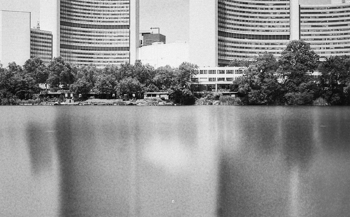

Today, I tried Ilford Delta 100 for long exposures in Wienna. I am curious for results.
transporti686
Apr 26, 2012
57
The negative looks very good. Section of sky looks smooth or normal from BW film (no structure as on my rolls of Ilford Pan F+)
transporti686
Apr 26, 2012
57
This is a normal long exposure from Ilford film. Ilford Delta 100, EI 50, Perceptol 1+1, orange filter + strong ND filter, straight from scanner, no postprocess. Original scan resized to 800x600.
