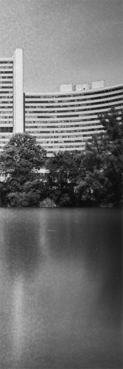

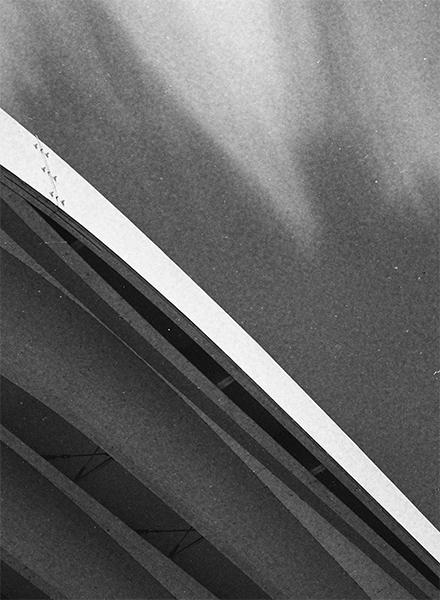

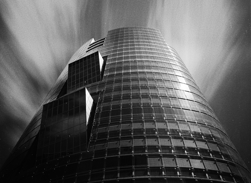

I got this result after scanning. This structure is also on negative. Picture is original resized to 800x600. Is it normal? I am bit disappointed wiht this result. This is a long expsure with Hitech 3,0 ND Pro Stop. Exposure time was 2min 30s. Scanned with Noritsu S-4 and then scanned with Nikon Coolscan 9000ED with nearly same result as Noritsu.
Do you have any pictures with long exposure on Ilfords BW films? I would like to see some works and discuss about this point. I would like to discuss about good choice of strong ND filter for BW negative.
