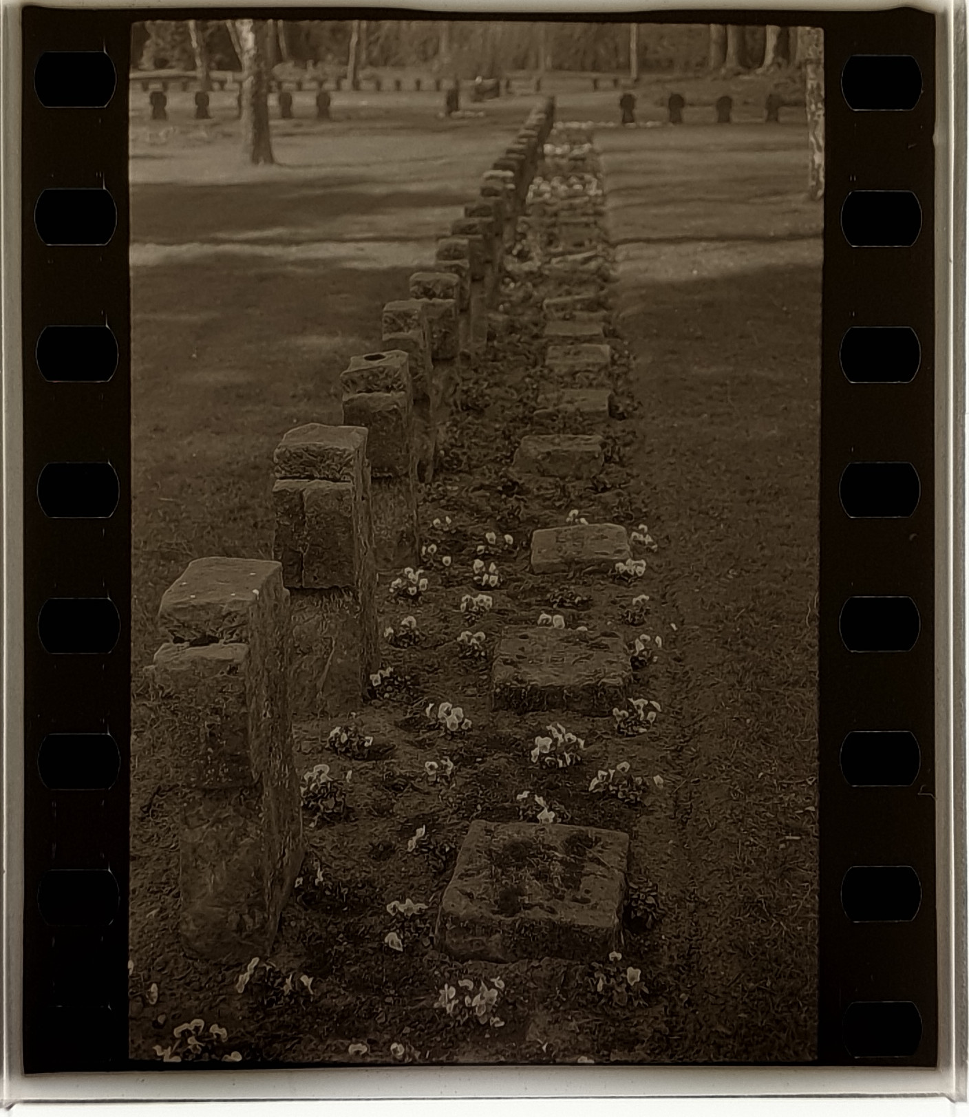

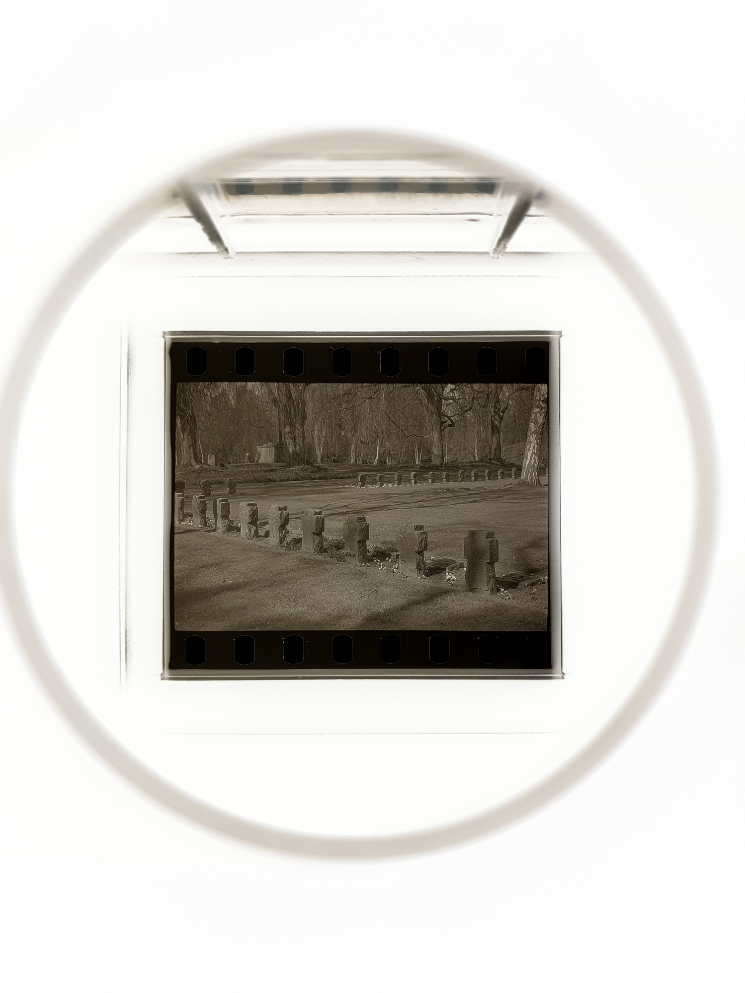

Right now it is on sale, only 39 euros, so I got myself one.
https://shop.lomography.com/en/smartphone-scanner
I will use it primarily when I am not home, traveling. It is really easy to use, and in comparing to other film scanners that I have - here you can scan and see full frame, and also sprockets as well if you are in to this kind of thing. Usually other scanners mask is cutting 10-15% of the negative, I don't like that.
Here are 2 examples - no editing except invert colors and resize in Gimp. Film used is expired Polypan F (that I used to test to see how bad is my fogged DR Summicron)
