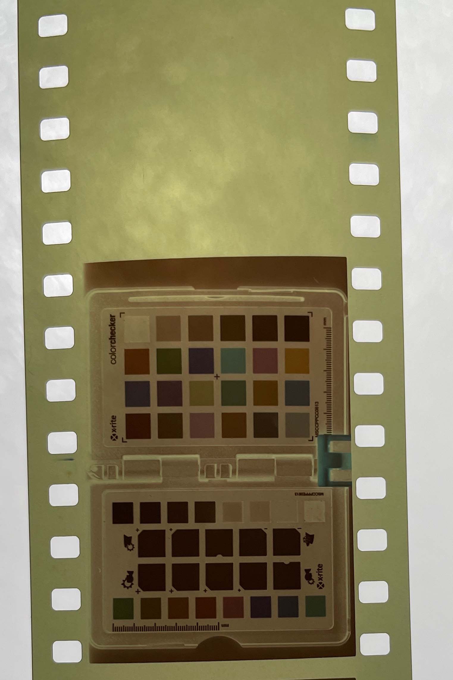

First off, it's not the same contrast as standard C-41. It's way more contrast. I doubt you could print it onto RA-4 paper. I measured the contrast by making a series of exposures of a gray exposure card metered at ISO 200, then subtracted two stops from that for my LD, then added 5 stops to that to form the HD. The (HD-LD)/1.5 for each color channel comes out to 0.49, 0.54, and 0.59 for RGB as seen by my digitizer setup (not intending to get into that, this is just a reference relative to standard C-41). By comparison, standard C-41 control strip (HD-LD)/1.5 comes out to 0.39, 0.48, 0.59 on the same setup. This undoubtedly makes for a difficult to print image if trying to print onto RA-4 paper.
The white balance multipliers to get a neutral white relative to film base plus fog are also quite a bit different than standard C-41: R1.243815 G1.000000 B1.138936. Standard C-41 comes out to: R1.172276 G1.000000 B1.368644
Assuming you could correct the contrast and get to a neutral grey in 5500K light on an RA-4 print, there's also the color palette to consider:
It's not exactly terrible, but not what I'd call the most awesome color palette ever. Given that it's C-41 and lately C-41 in general has been hard to come by, this could be a good diversion. Also, LOMO states that it's a 100-400 speed film. Nope. I metered it at 200 and the normally exposed grey exposure card came out exactly where I'd expect it to relative to the film base plus fog for a 200 speed film. You can expose it 100-400, but it's best at 200.

it’s very weird looking… there’s no orange mask, it almost looks like XP2 Super when holding the film base up to the light. I need to do this same exercise for lomochrome purple, but don’t have any rolls on hand right now.

Here's what it looks like when held up to the light. Not a typical looking C-41 with the orange mask.

It reminds me of the old (1950s/1960s) Agfa CN17 colour negs. They didn't have the orange mask and had the greenish colour like your sample
The lack of a mask, plus 'correct' sensitisation for a masked colour neg could produce the effects seen (essentially from overlapping absorption maxima). Sandwiching it with a piece of unexposed & processed regular colour neg would likely answer the question...
The existance of a mask or not should not be handled by spectral sensitisation. If the couplers as such cannot be changed the, interlayer effects could be used to counter the misabsortion of the image-forming dyes.
The generation of Metropolis shown here quite likely has neither a mask nor much in the way of interlayer scavengers - and there's no point in trying to find couplers etc that work in a maskless film if your end aim is a masked C-41 film (as would seem to be the case here). In fact it seems quite accurately in line with what a colour neg film before it has mask & interlayer components added would look like.
