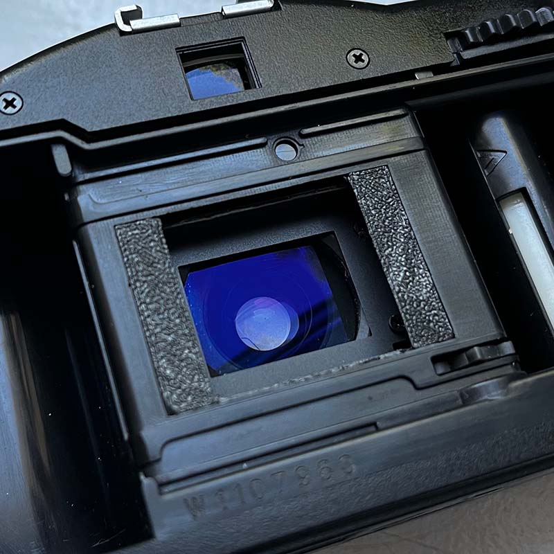

Did a quick print and... it fits.
Will do a more "production" ready print when I have more time...
Thanks again @xya!

The "plain" insert is now shared at thingiverse: Lomo LC-Wide square insert
It's 0.2mm bigger in height than 23.5mm that @xya's measurement and has slightly rounded corners so images on film should in theory have less problem of slight light leaking into the corners on the negative.
Push the insert into the camera until you feel enough resistance to ensure tight fit. My insert is slightly narrower at the bottom so it should only start touching the camera's film gate opening at the end. The insert slides into the camera deep enough that it never touches the film so you can get away with prints that are rougher than what you would've wanted if it was touching the film.
It's hard to explain if you don't have a camera in front of you, but the insert only provides the vertical portion of the frame so the perfect corners are pretty much impossible to get. Most probably you might get a corner like here in the upper left corner (this is not my picture and the user is probably using the OEM insert):
18a ~ Eleven by Jason Kimes by Lance Rothstein, on Flickr
I have two other designs that should make the corners nicer. I'll publish and share them here later...

Thank you! It just hit me- anyone have any opinions on using white or lighter filament for an interior piece like this? I’m assuming there’s a reason all manufactured pieces are black
brbo
brbo
Dec 28, 2011
2,365
EU
Yes, there is a very good reason why everything is (matte) black in every camera. Reflections.
