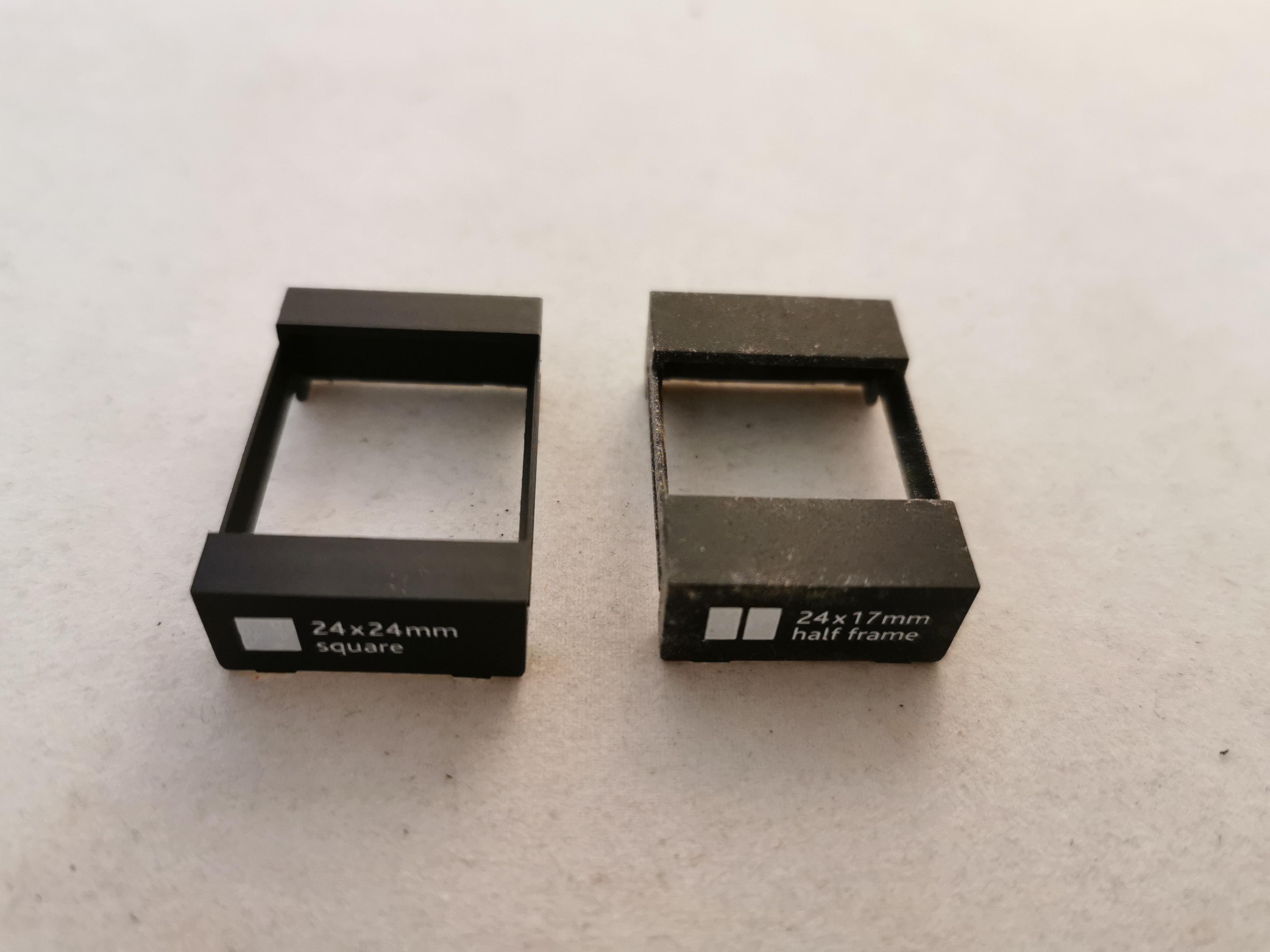

Does anyone:
- have square and half-frame inserts that they don't need and would be willing to sell
- have 3d print files for them
- have closeup pictures and dimensions for those inserts
- knows where to get them
I asked Lomography if they would sell a pair of those to me and they said that they will try to find a pair, but never got back to me, of course. I guess they figured they would be better off if I just bought a whole new camera to get them.

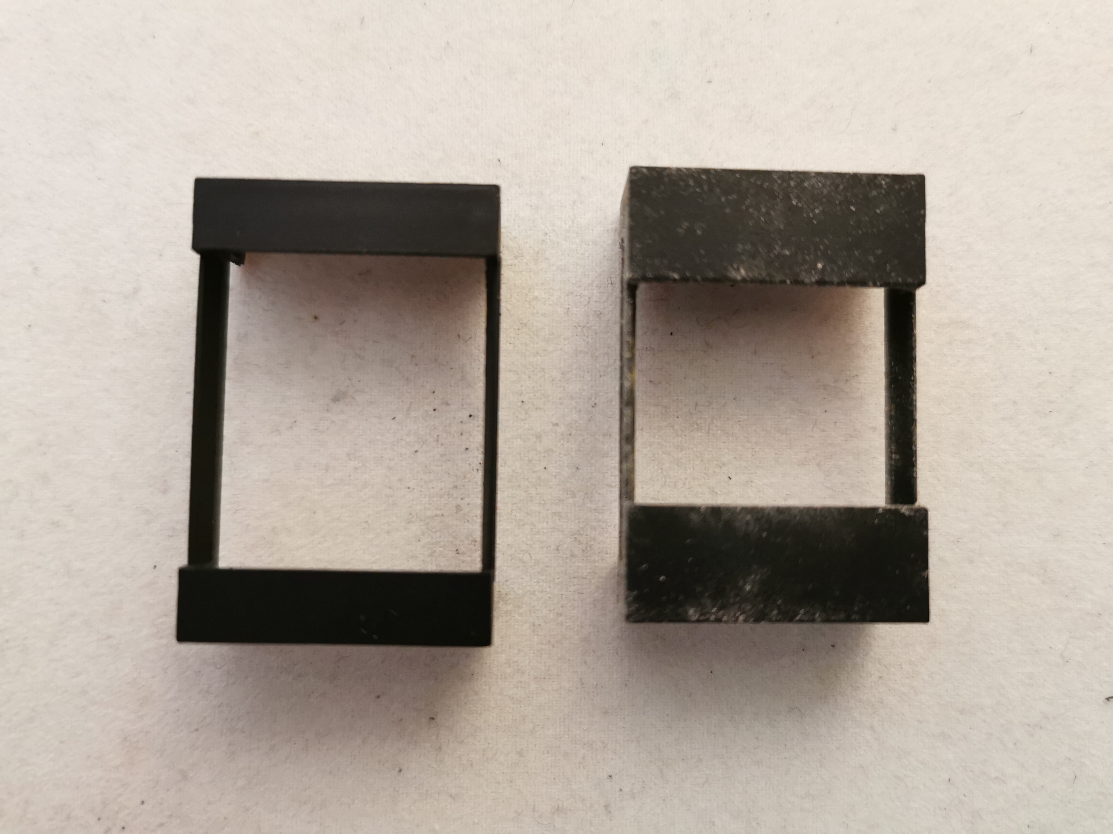

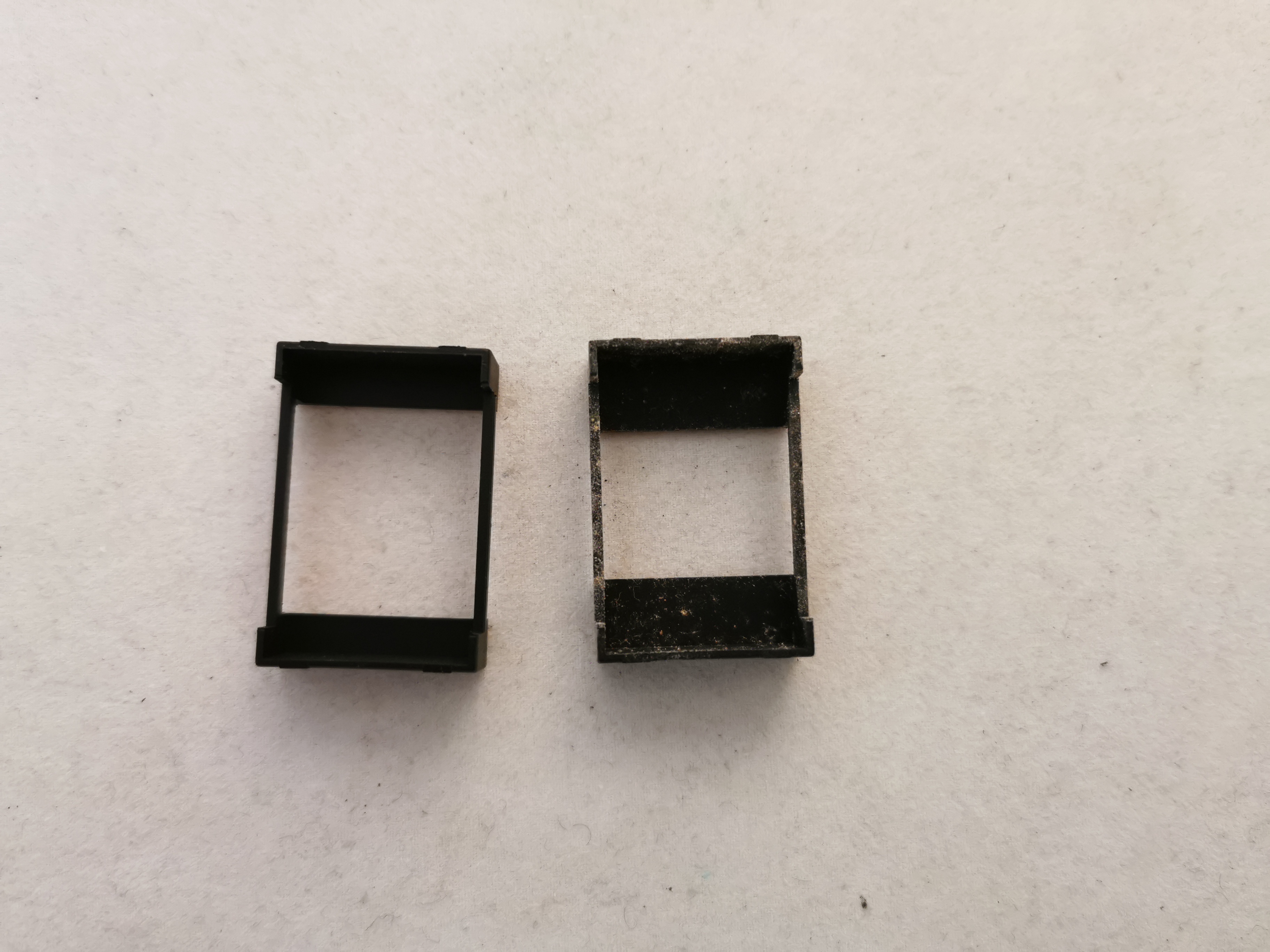

I have both, here are somes photos. I will make a second post for the measures
xya
Jun 13, 2010
1,032
Calais, Köln
I posted full resolution pictures, out of the camera, not nice...
Both are 35.0 x 23.5 mm from the outside. Overall height is 10.3 mm.
The openings are 21.8 x 17.3 resp. 21.8 x 24.2 mm.
Thickness of the plastic is 0.9 mm except the longer sides which have a little "profile" visible on the photo, they are 1.1 mm in total.
I you look at the longer sides, the 10.3 mm divide into 2.3 mm incursion from the top, 4.2 mm frame and 3.8mm incursion at the bottom. Top is the film plane. Hope it helps...

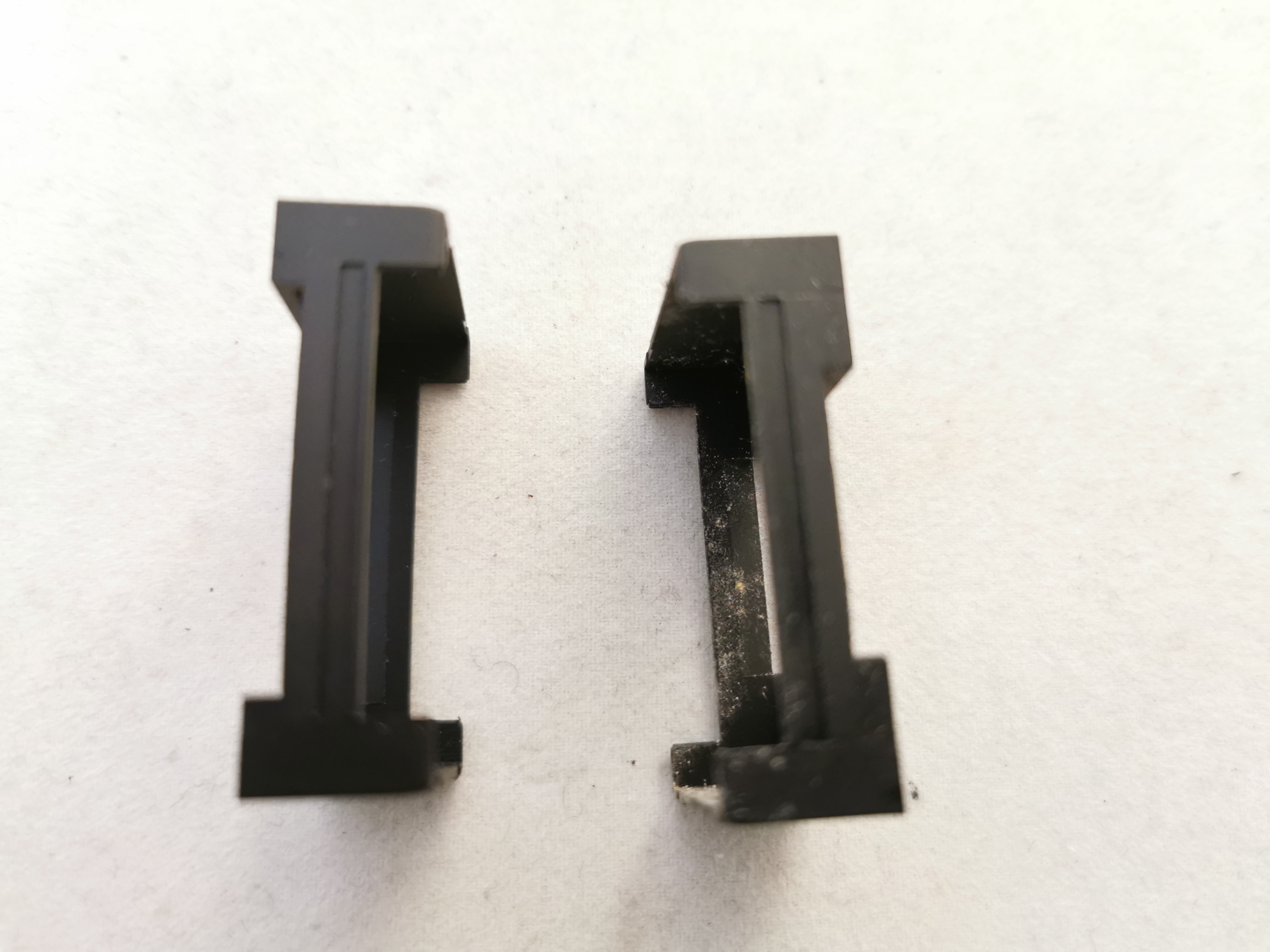

One question, do you think that the channels on the sides visible in the last picture serve any purpose?
xya
Jun 13, 2010
1,032
Calais, Köln
I have looked at it again. I think it's for stability reasons. The channels make a rib at the inside, hardly visible, but you can feel it with your fingers. The rib is round, not as sharp as the channels are. The plastic material on the side is 0.9 mm as the rest, channel and rib make it 1.1 mm when you measure with a caliper.

Sure, they have to slide into the opening, but looking at the masks they don't seem to block any light on the bottom and at the top of the film gate, just left and right.

The lens on LC-Wide sits so close to the film plane that the vertical bars in the last picture cant possibly be in the way of the light cone, thus not blocking anything in vertical direction.
brbo
brbo
Dec 28, 2011
2,021
EU
No. You are probably just missing the fact that the horizontal bars connecting the vertical bars do not extend to the image plane. They are recessed, so not in the way of the light projected on film.

@xya, can I trouble you for just one more thing?
Can you please measure the distance I marked on your image? And are there small feet on the bottom?
Thanks!
xya
Jun 13, 2010
1,032
Calais, Köln
No trouble. The first photo is easy, it's 26.7 mm. The second is difficult to say. At the red circles there are no feet but incursions of about 0.1 mm or a bit less, hardly visible. Outer distance of the 2 incersions is 17.6 mm, inner distance between the two is 12.7 mm. It seems as if they have "rounded" or "broken" the outer edges of the frame except for the incusions.

Did a quick print and... it fits.
Will do a more "production" ready print when I have more time...
Thanks again @xya!
