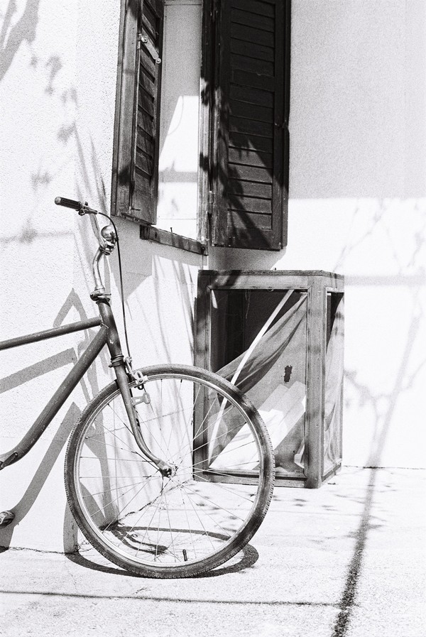

It came out quite grainy, highlights are a bit over the top. I'll probably try 'normal' developing next time...
Still I like the images... I'll make a few prints tomorrow and see. Just bought the multigrade filters :smile:
Dec 29, 2018
982
USA
Traditional
You definitely didn't lose any shadow detail, that's for sure. The heavy grain is characteristic of rodinal, especially when scanning, but can be less apparent when enlarging.
A good candidate for multigrade printing as you mentioned. Good luck!

Grain is not an issue when enlarging at 5x7 size. As you said the grain is most distracting when scanning film, but that can be dealt with software :smile:
I kind of like these overblown highlights on my screen, but when printing they are just too much, very contrasty negatives.
I think I'll get some Perceptol and try to develop my next film with it...
