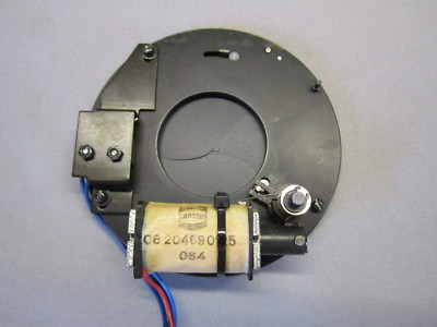

On another note, there is this inexpensive German-made shutter that you might experiment with?
Very simple shutter for being German. Just a shutter blade assembly and a solenoid. How fast is can be would be up to the solenoid and the electrical impulse. Maybe a mini computer could be used as a controller.
