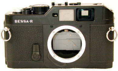

A cursory look at the CT1 shows that it uses a vertical metal blade shutter made by Compur, very similar to the modern shutter designs used in DSLRs. It is specifically the Compur Square shutter which was a drop in unit used in many cameras because it was simple and reliable and reduced development costs. This is exactly what I'm looking for, except Compur stopped producing them long ago.
I'd think that all DSLR shutters operate exactly like old film shutters, being that they wouldn't be much good as a shutter if they let light through.
But I do believe the Bessa R had additional light baffling that the CT1 and its SLR variants did not due to the mirror
