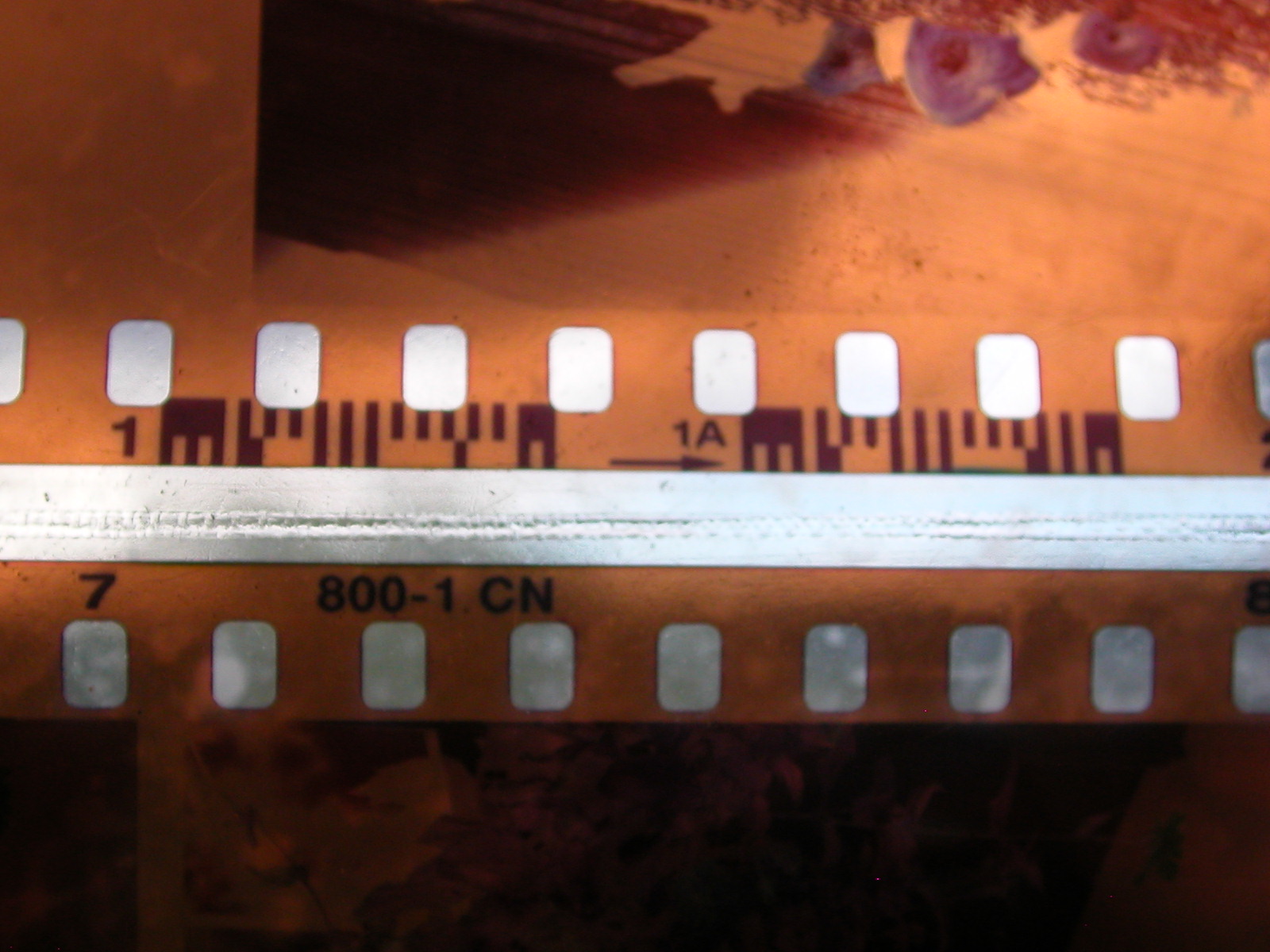

Believe it is in fact Protra 800... for those who have some developed, I be curious to see if it has the same code on the film strip as Porta 800..
CN 800-1 800-1 CN
Could someone verify?

This site suggests that Lomography color 800 used to be Ferrania Solaris FG Plus 800 and is now some unknown Kodak emulsion. Personally I can only think of two emulsions which could be sold as "shoot at EI 800 and process in C-41 soup": Kodak Portra 800 and Kodak Vision 3 500T movie stock. Since Lomography specifically highlights that the film can also be processed in ECN-2 chemistry, something they'd be unlikely to do for Portra 800, this would suggest that we're looking at Vision 3 500T movie stock here. Sample images I see on flickr don't show the red halos around specular highlights, so we don't really know.
A question to all those who have used this film: does it have frame numbers by any chance? We know that Portra 800 has them, whereas Cinestill 800T doesn't.
Rudeofus
Aug 13, 2009
5,115
EU
Yes it does 1 - 36.

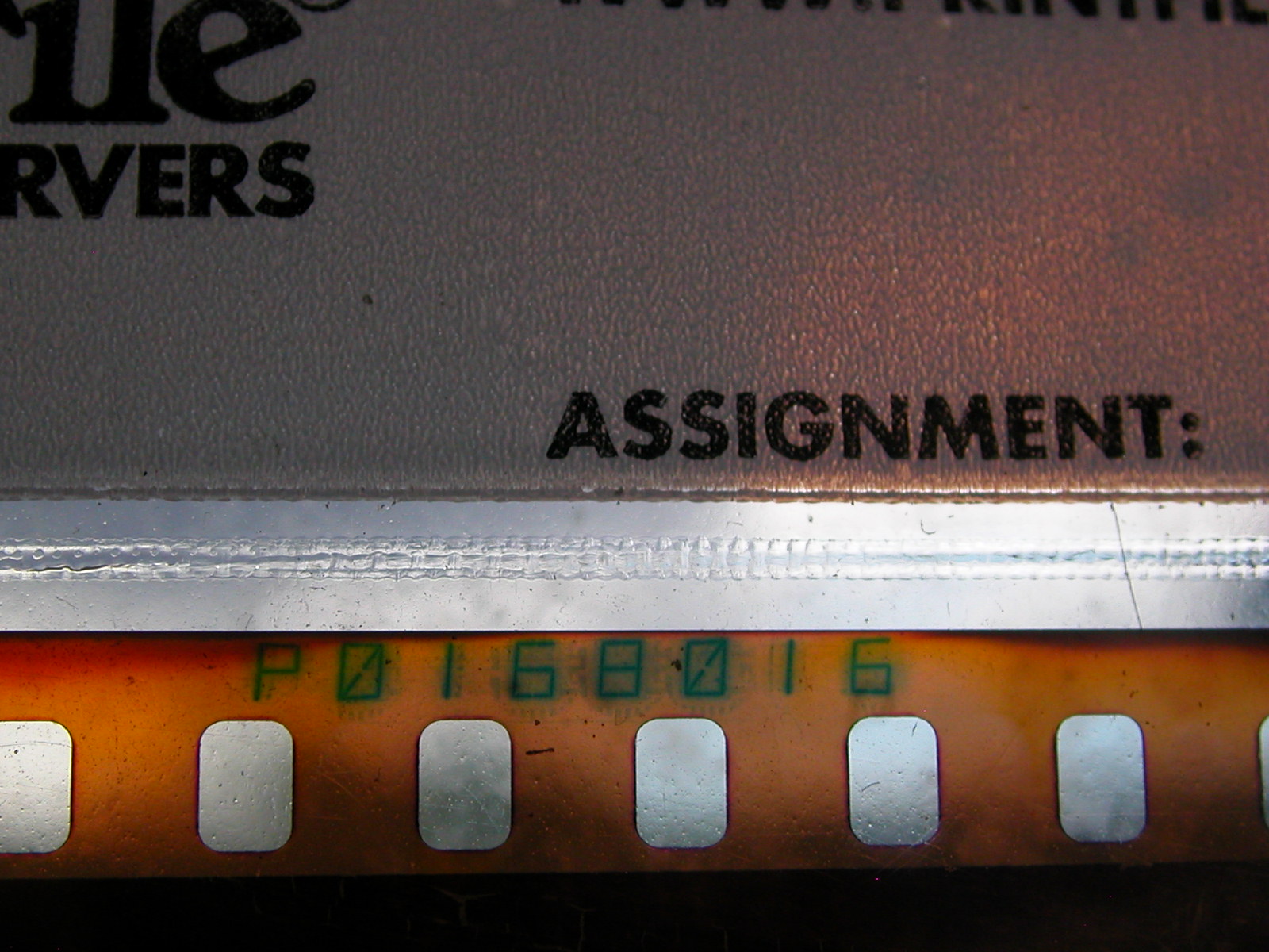

Can you somehow describe what else you see one the frame rebates? Anything which would specify the emulsion? Could anyone compare this to what's inside these single use cameras?

Here's a shot of the first frame with some number
here is the same first frame but at the bottom.
