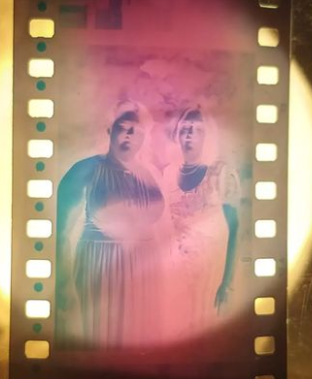

I developed my first roll of lomochrome purple recently, it was the last of many rolls, so I put it in with the roll of old expired color film. (I dont normally do two at once, but I was tired)
I was kind of surprised to see when I took it out of the tank, that it had a very purple band running down the center of the regular color negative. The sides of the film look normal.

When I get home I will post an image of both films next to each other. Lomochrome purple is composed of three color dyes. I dont know which leaked out and stained mine. You also have to understand that the staining of the film may have started from the edges too, and the center of the film is least affected. This might be more plausible, because I notice the same pattern of absorption when bleaching very dense B&W negatives.

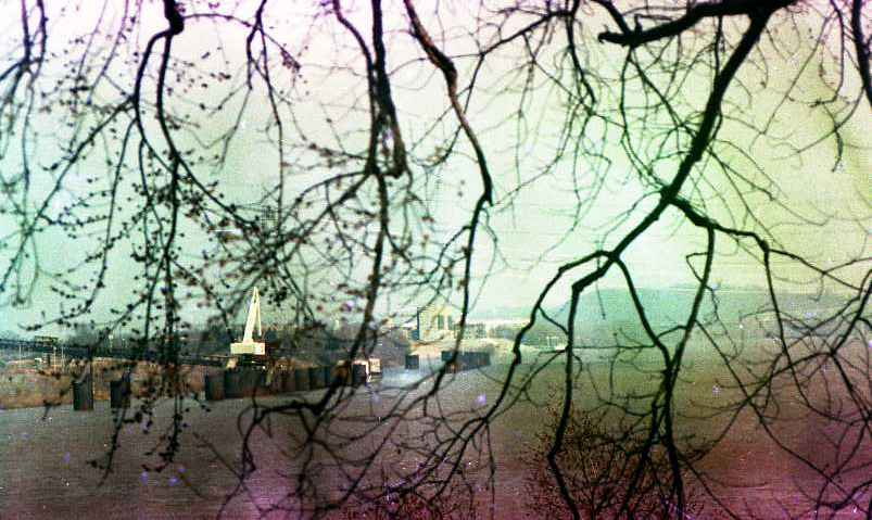

I plan to develop more film this weekend. I will develop half of the same roll without the lomo purple in a clean dev, and the other half with a roll of lomo purple. I am confident that I am correct though, as I have developed the same Focal color film before and no such banding has ever occurred. Nay, I have never seen such a banding.

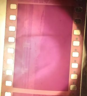

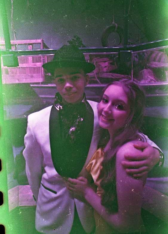

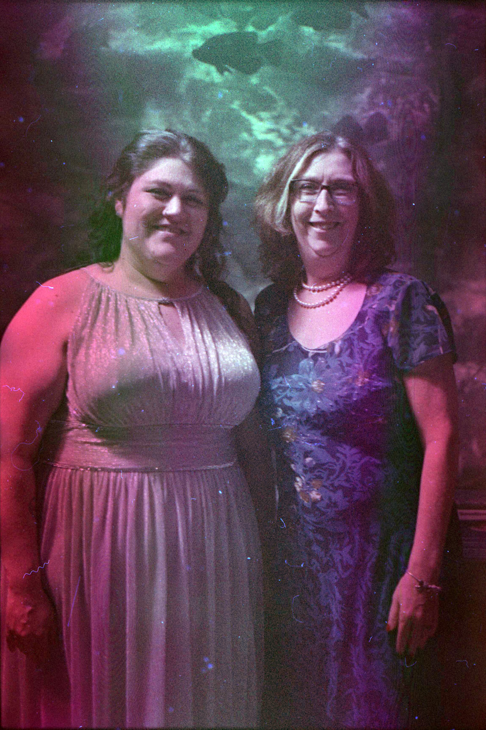

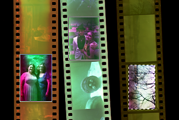

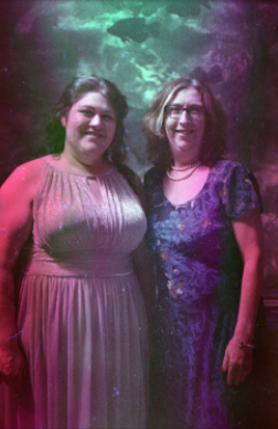

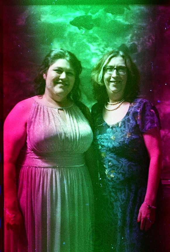

1: Affected color film (dense, pushed bc it was indoors)
2: Lomochrome purple (also pushed)
3: Unaffected color film

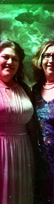

number 4 is scanning the strip in the middle that is not affected, it comes out normal.
You can see the normal color film starts taking on a lomochrome purple appearance on the edges. The actual lomochrome picture looks like a mirror image of the correct color image.
affected lomo purple unaffected
My theory is that Lomochrome Purple has some sort of coating or dye that comes off in the dev that ended up staining the regular film? Not really sure what caused it.

The image f the two ladies and the colour cast at the sides reminds me of film that was affected by heat and/or damp.
