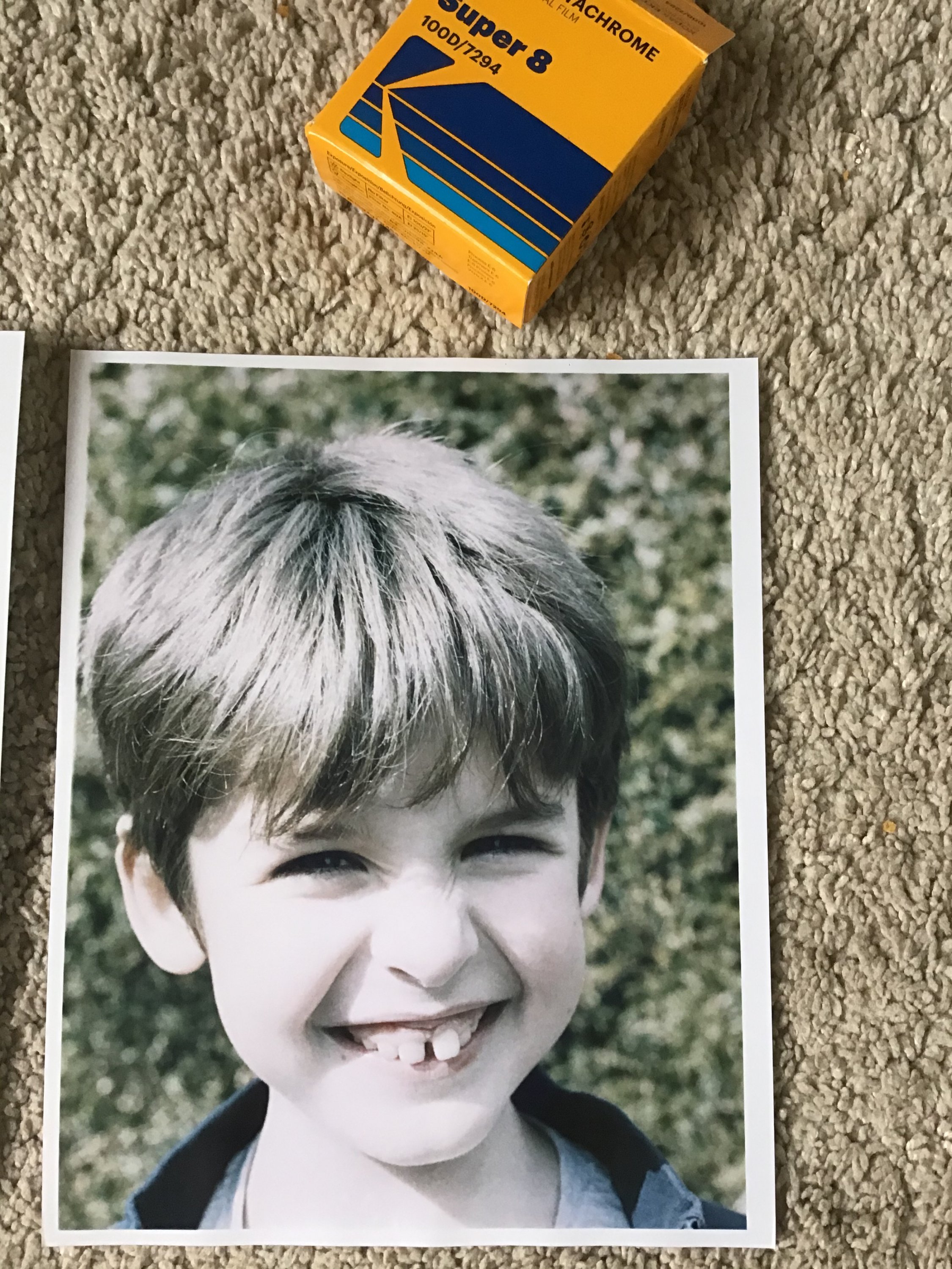

Odd film that produces green negatives. I was unsure where to start or even if I could balance the print. I suppose I wanted to see if the odd nature of this film I'd seen in scans was 'real' or a product of software. Here's my progress starting at 0M/0Y which produced a most striking print!! I proceeded with large 50cc changes for each print after the fourth decided that the best would lie somewhere between #3 and #4. Final print is on the right.
Our boy has a typical Northern European complexion and that hedge behind is deep green.
Please note these are taken with an iPad which does seem to exaggerate colour and contrast although here it seems to have subdued colour quite a bit. I'm going to look at these over the weekend and fine tune on Monday. So far it seems the odd desaturated look with a magenta cast is also there in the darkroom.

Here's another shot of the final print on the right this time with an Ektachrome super 8 box in the shot so you can see how the colours are tweaked by the iPad:
