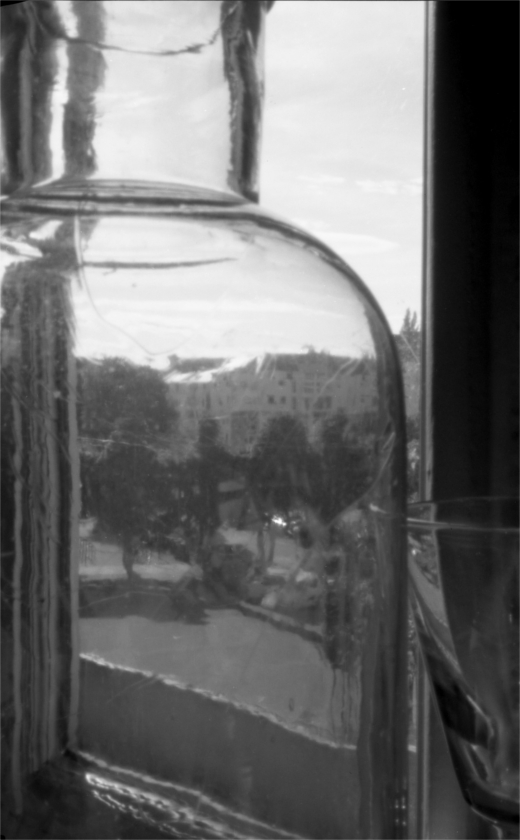

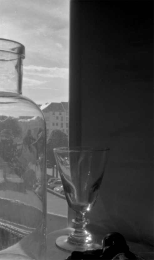

Well I've put a roll of the Lomo Lady Grey 120 film through a pinhole camera, and decided to expose it using the times for HP5 in terms of reciprocity failure. That worked out pretty well, I think.
This film was one of the most ornery when it came to loading it onto the reel, though, and the same thing with trying to get it into the holder for scanning. The curl to it is really something, trying to load it was like trying to get my cat into his cage when it's time to visit the vet, all curled up on itself and not willing to co-operate.
These are two of the images. Film developed in XTol 1+3, 2 minutes pre-soak, 13 minutes developing at 20°C. The grain is agreable, not too obvious.
