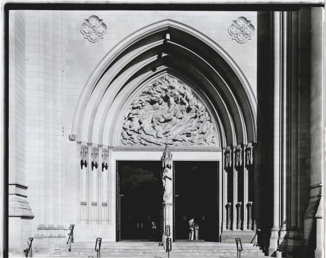

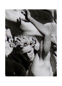

I took a print that I made on it down to Scott Davis today and he will scan it for me. I'll post it here. He'll be careful to try and preserve the color.
This is my first serious attempt at a good print with Lodima. Scott included color information in the .jpeg, but this is still much colder than the print. The best approximation to the color I'm getting is the banner at the top of M&P's website.
This print was made from a 400TMax negative (old) developed in Pyrocat HD. I think it really shows off the incredible scale of this paper. I put the darkest shadows (the middle of the right door) on Zone IV and the brightest areas (the panel above the doors and the sunlit stone on the left) fell on Zone IX-1/2. I gave it N-1 development. I had to use a water bath to get the highlights right.
The negative is incredibly sharp. You can see the piano wire mesh that the Cathedral has placed over Ex Nihilo to keep the pigeons off of it with the naked eye on the negative. The paper is not quite as sharp, as you need a loupe to see the wire, but it's still amazing. One of the guards asked me if the camera lens would resolve the wires. You can't see them from the camera position. I told him I didn't know. Now I know.
Thanks to Scott Davis (The Flyingcamera) for scanning this for me.

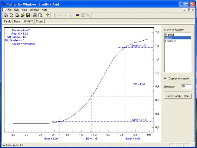

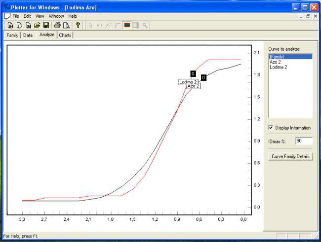

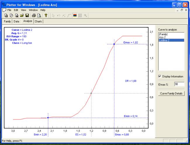

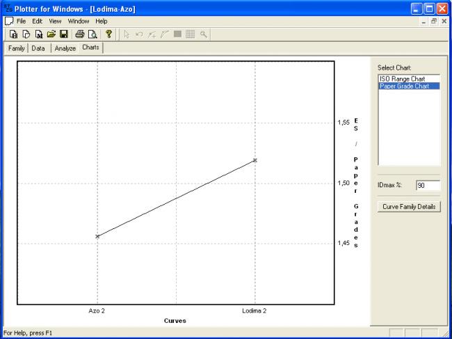

I did some comparative curves between Lodima #2 and Canadian Azo #2 - both developed in Amidol for 1 minute.

You are looking at a grade 2 vs a grade 3 paper just eyeballing the curves. Maybe the difference is even greater. I would have to compare thise with my standards here for better analysis.
I've posted curves and speed comparisons here with my Azo type emulsion.
