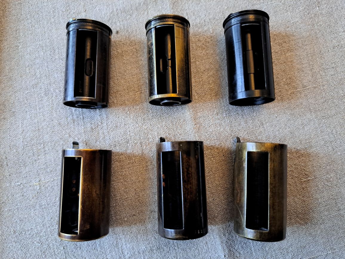

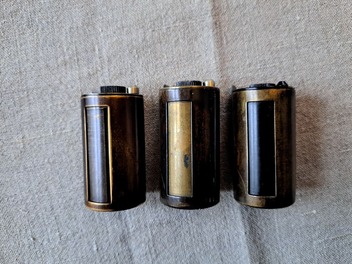

I use these a lot, since I only shoot black and white film, and turned to bulk loading to save money. I was buying them, often in mixed lots, and have two (that I consider FILCA) that are like the one in the middle, between the 'IXMOO' on the left, and the more normal 'FILCA' on the right. Once one of them came in a lot marked 'IXMOO', probably based on the chrome knob, and the fact that the outer shell says 'Ernst Leitz Wetzlar' and 'Germany' on the bottom. The inner shell, though, is shorter, just like an IXMOO. It will fit in the IXMOO outer shell, and for a while I thought someone had swapped parts, but obviously a FILCA inner shell won't fit in an IXMOO outer, so they should have caught their error. I have heard that there were several generations of these but I don't have the whole story.

One of my FILCA's is different. It doesn't have any text at the bottom, whereas the others say 'Ernst Leitz Wetzlar' and 'Germany'. It is actually the one on the right in the picture I posted. But it does have the groove that aligns the shells and seems to be like the others.
