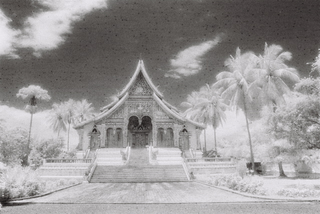

i checked my neg. the spots on the neg seem to match the PP spots. they are way too uniform to be dust.
eddie gunks
Dec 14, 2005
1,156
Saugerties,
okay, some scans i found. maybe it is no the PP.
the first is the worse. it is the longest expired stuff. the second is the same batch just taken earlier last year.
eddie
DaveOttawa
Sep 13, 2005
285
Ottawa, Cana
...i thought i was on top of this by just ordering new film...
eddie
Oh dear. These are the worst HIE pinholes I've ever seen. The pattern looks random to me = NOT the pp.
As far as I can tell from the scan exposure looks like something you can work with though.
New film will probably be a lot better if it's been stored cool since purcahse and is processed promptly after exposure, so far your results seem to point to aged film as a factor.
