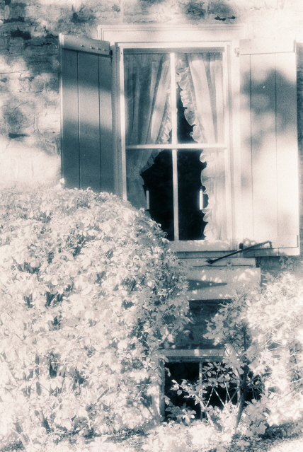

thanks guys! it looks to have been the film. a shot from my tset roll.
eddie
DaveOttawa
Sep 13, 2005
285
Ottawa, Cana
eddie
So I take it this was non-expired ilm, cold stored until exposure and processed shortly after exposure?
Good luck with the wedding shoot, hope everyone likes the IR work.
