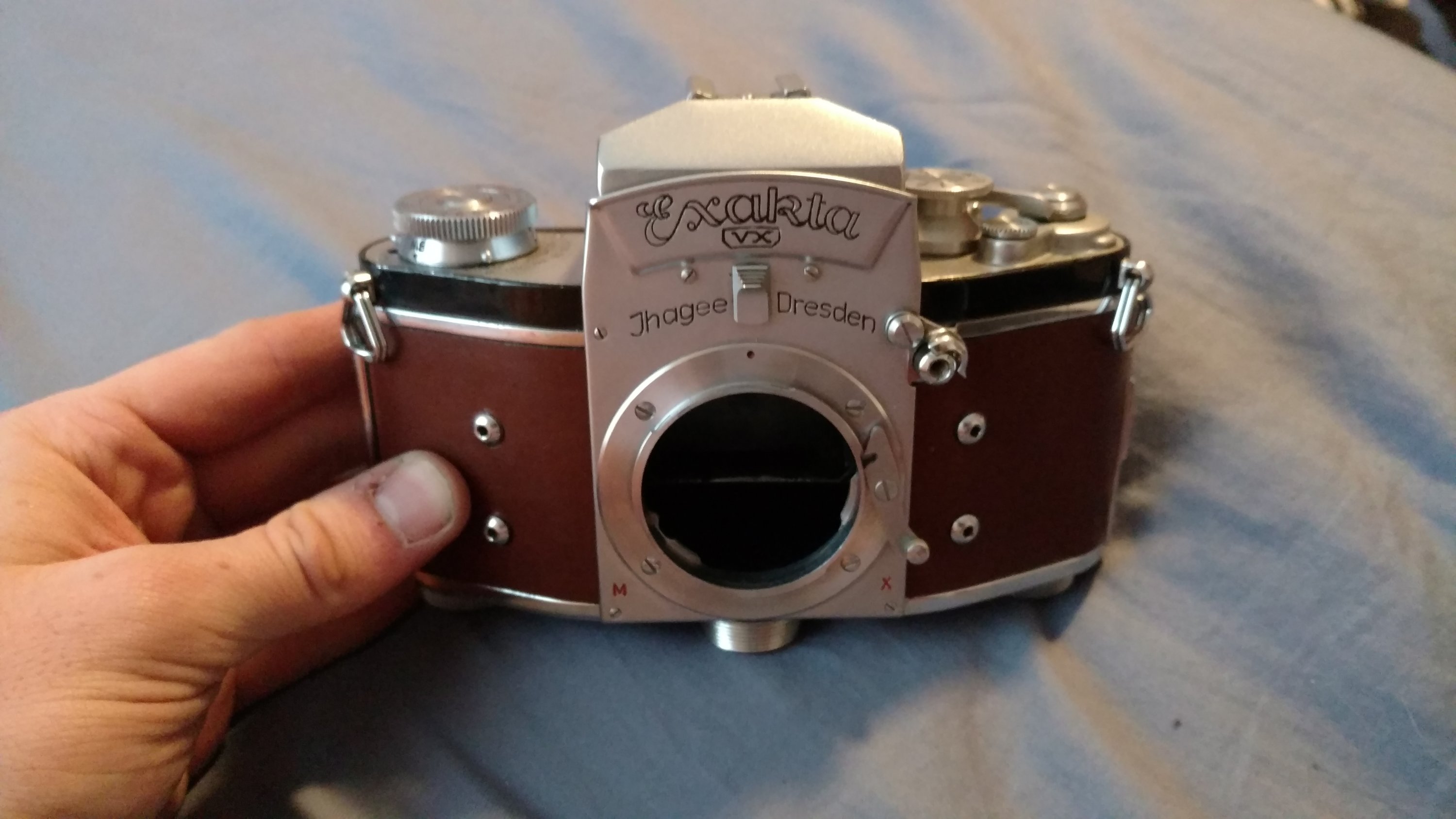

Here she is after I detailed the front letters and cleaned her up.
The split-triangle fastener is a newer accessory. Contempory fastener would have been a carbine-ring attached to a line.
Not sure what that means haha in new to 35mm and Exakta
I refer to the fasteners to take a strap to hang the camera on your neck.
Could that brown covering be a user modification? (You already hinted at this with your remark on covering kits.)
Ohh I see. I was going to take them off as the one on the left sometimes gets stuck in-between the winding lever and the body.
If it is props to whoever did it because they did an amazing job, the fit is super tight. I sometimes wrap cameras and I have to use my laser cutter to get it that nice.
With a laser cutter you likely are King among us tinkerers...
I don't know about king haha I have a YouTube channel where I build things and I work in the classic car restoration industry so a variety of tools is a must. Im gearing up right now to make my own camera. My vx came with a second camera a Varex. Not sure what the difference is but the shutter was supposed to be jammed however I have found that not to be the case. I can't tell if the speeds are accurate but the problem is that the knob to set the shutter is in the wrong spot in comparison to the shutter speed. If I get it working it's going up for sale for pretty cheap.

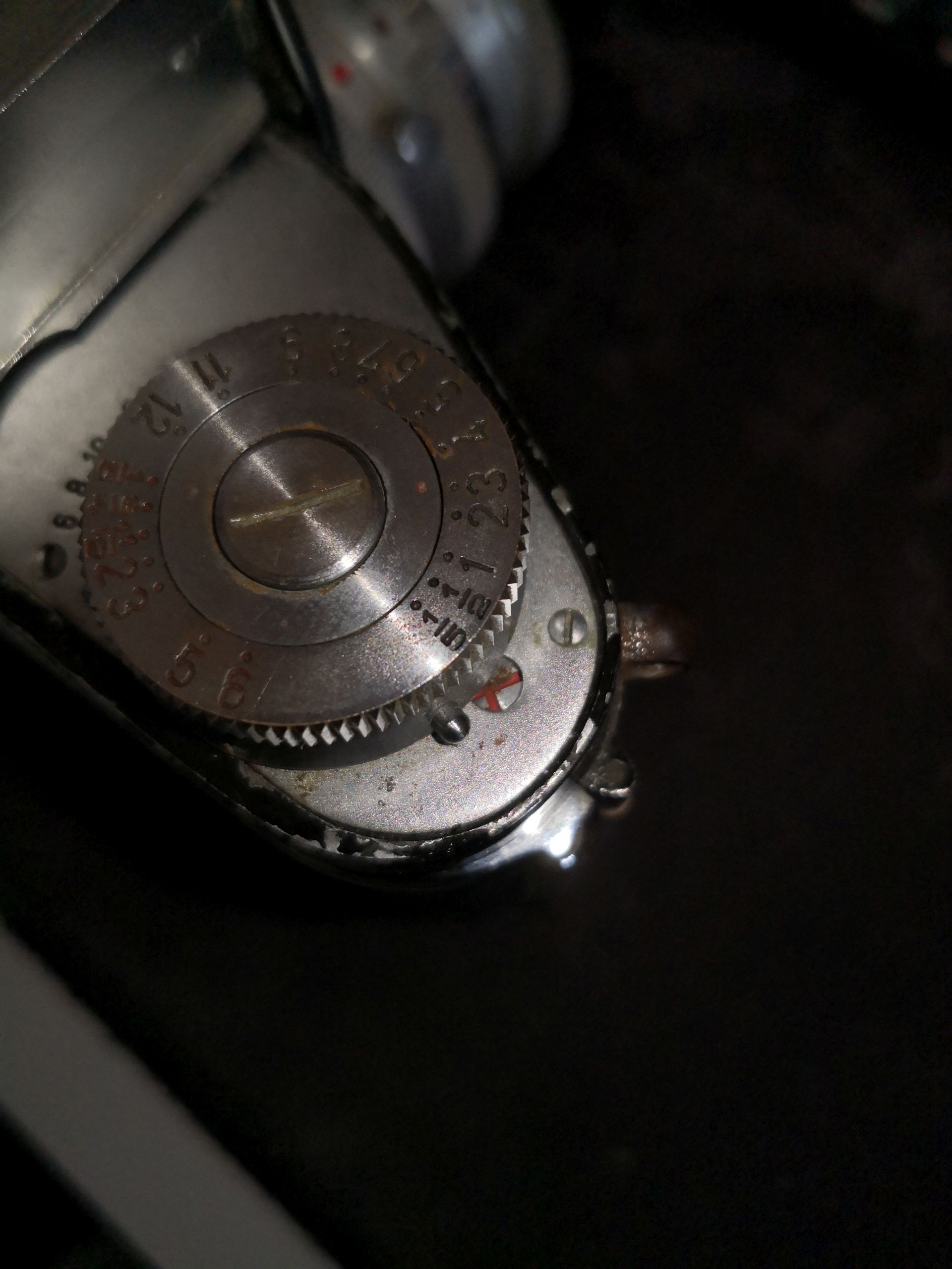

How do we know the film is correctly loaded onto the take up spool? Modern SLR can see the direction of the rewind knob turning...how about VX?
There is a little window on the top plate, far right side, next to the slow speed dial. In that window re some lines that you can see turning as the film feeds through. That was an issue for me until I found that out.
So is this loaded correctly?
I do not know if it is loaded correctly, but as you wind it, the redlines should rotate. This tells you that the film is moving from teh feed cartridge to the take-up spool. This is the same indication that you get watching the take-up spool rotate on other 35mm cameras.
Ok noted with thanks...will observe that indicator when I go for next frame later. 🤟
