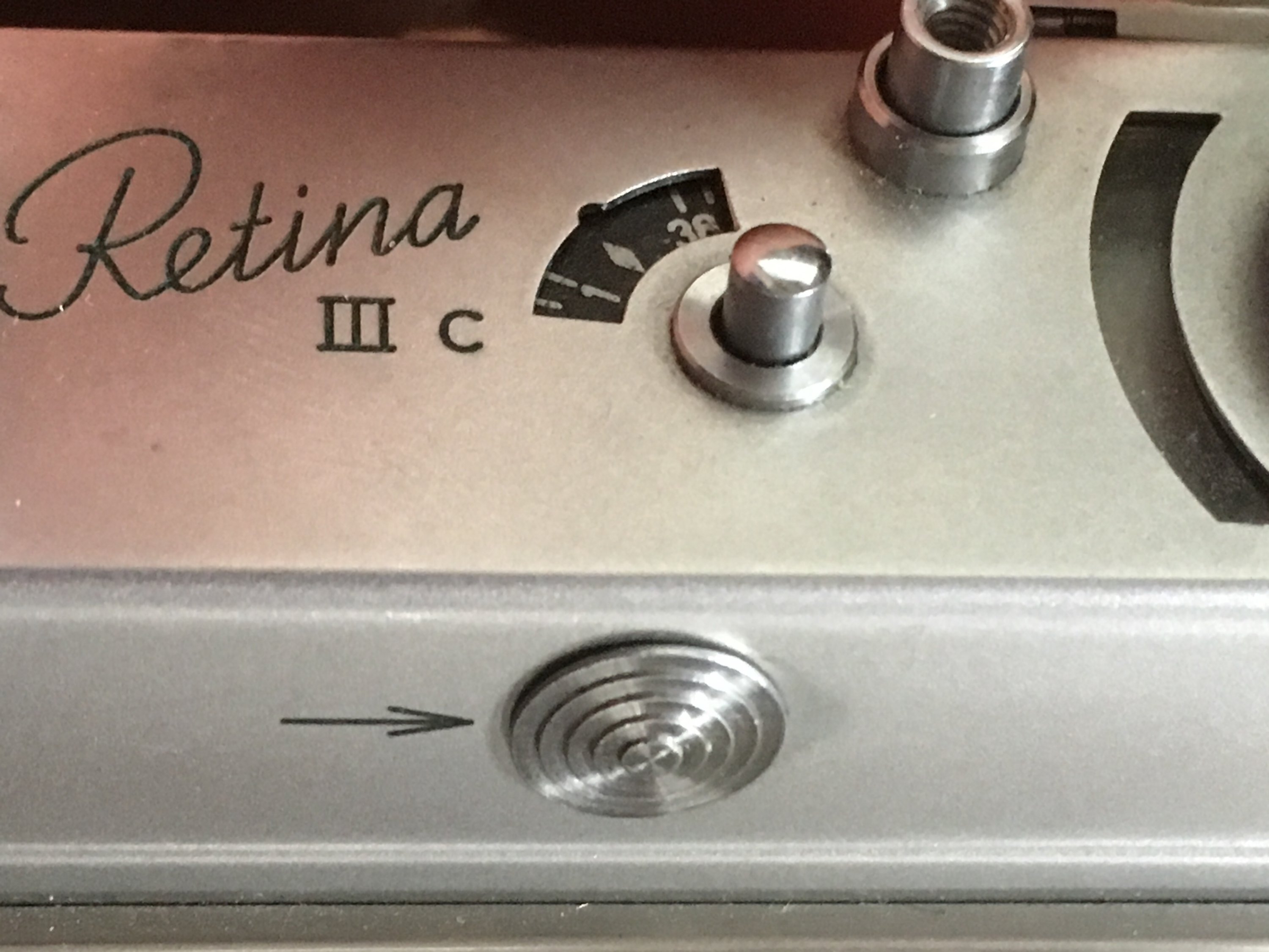

They are NOT telling you to use the Film Advance lever on the underside of the camera to set the frame counter - that is done by pressing the button immediately adjacent to the frame counter, and pumping the large button with the arrow indicating direction of action (see photo) with your thumb until the frame counter reads 36. You do this action only AFTER you've got the leader started on the take-up spool, closed the camera back, and then advanced the film two or three frames to bring fresh film into frame. Of course you need to fire the shutter after each cocking of the advance lever. Does that clear things up?

OK, I just grabbed one of my Retina IIIs and loaded a roll.
You CAN load the roll and advance the film to frame one without opening the front of the camera: place the cassette as you would with any 35mm camera, thread the leader and close the back. Wind the rapid-wind lever, and to wind the film another frame, press that button next to the frame counter: this disengages the advance lock (normally disengaged only after you fire the shutter) and lets you crank forward another frame. Do this 2 or 3 times and that will set you up for your first frame. Be sure the frame counter notch is pointing to frame #36 and you're set!

Yes, advancing the counter can be done with the lens closed. Just hold in the top button and repeatedly slide the knob on the back to the right until the frame counter reads where you want to start (usually the diamond before 36). Then you need to fire and advance the film with the film advance at the bottom and that needs to be done with the lens extended.
