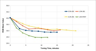

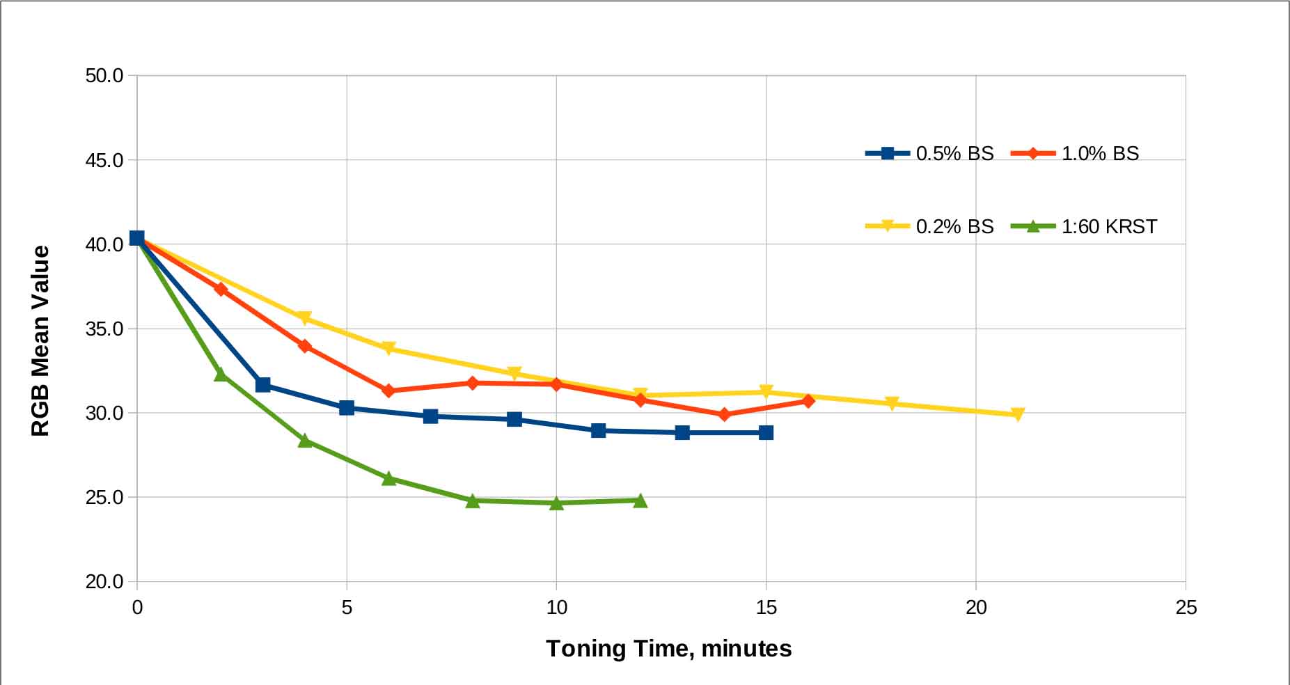

In any case, I did some experiments on Centennial POP for which earlier I had developed a selenium (KRST) process to tone the orange-red color to chocolate-brown color with significant increase in Dmax, an equally important goal to pursue.
Here is a graph depicting curves of POP Dmax (as measured with a scanner in the form of RGB value) as a function of toning time for various concentrations of black slat in comparison to the standard KRST (1:60) toning:
The process is fix, hypoclear, wash, 2% Na2CO3 for 5 min and then straight to toner. The black salt toners are simply black salt in dist. water prepared right before using. Earlier I had found that adding Na2CO3 in the toner itself, as it is in a typical polysulfide toner, slowed down the toning rates considerably so I decided to skip it.
Evident on the chart, It seems that 0.5% black salt is optimum (the blue curve) for this paper. Lower (0.2%) and higher (1.0%) both were slower and and less effective than the 0.5% formulation. The only theory I have right now as to why toning slows down at higher percentage would be that there is simultaneous bleaching and toning going on in the toning bath and perhaps bleaching becomes more dominant at higher salt percentages. Incidentally, I found that 0.5% was also optimum for the salt-free salt process that I reported before. In comparison, KRST (1:60) is much faster its reaching the full toning potential in addition to giving an extra boost in the Dmax compared to the black salt toner (Mean RGB of about 25 compared to 30 or so in the latter.)
