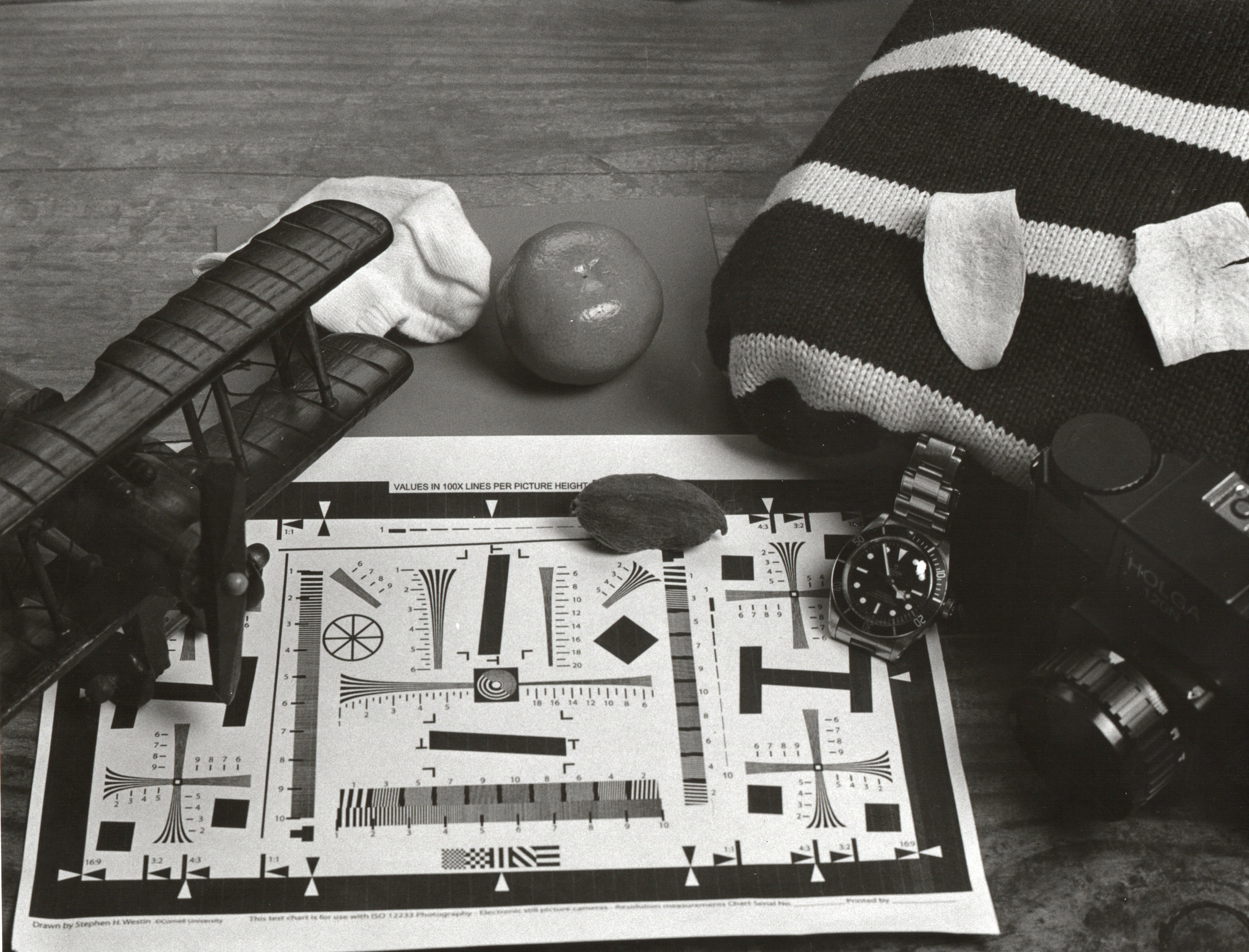

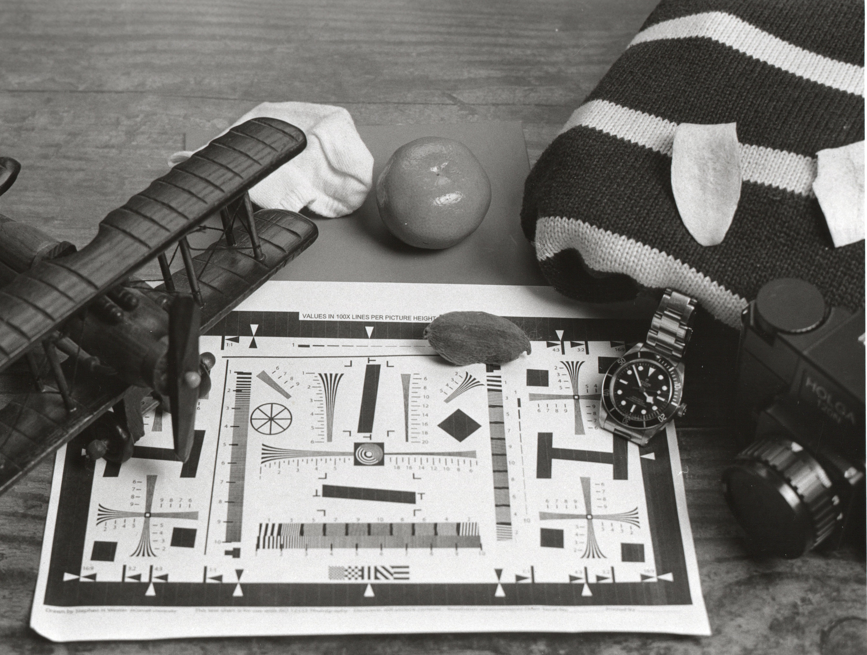

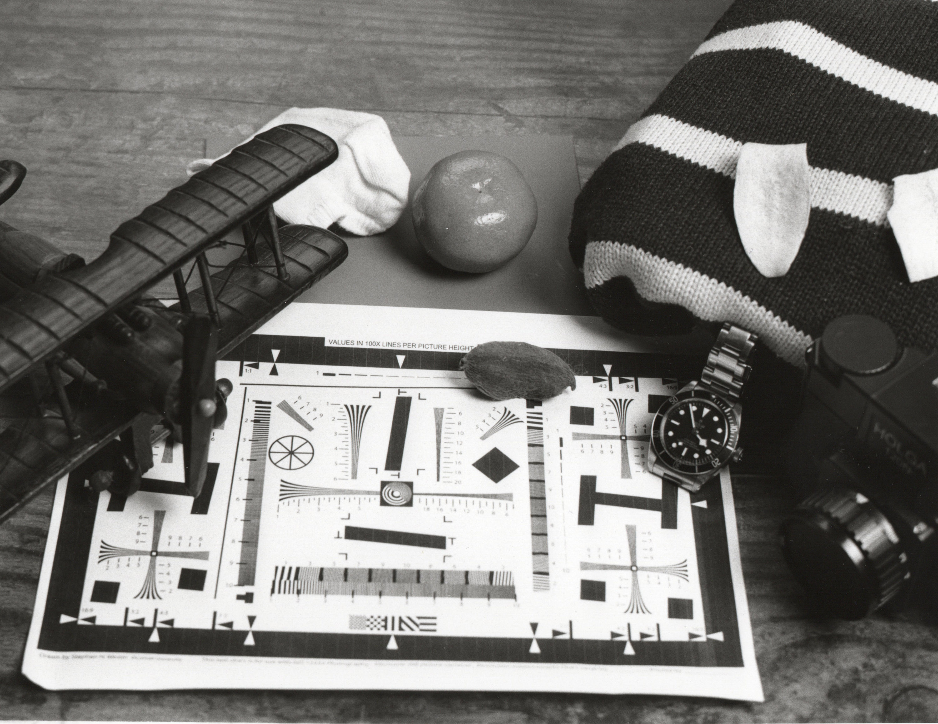

Whole 8x10 prints (all printed identically with a condenser enlarger in my community darkroom).
D23:
Rodinal:
HC-110

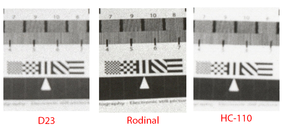

Details comparison (around 2.5cm or 1 inch in the actual print):
As expected, Rodinal is the grainiest of the three but with this film and enlargement it's only really visible if you look carefully at the test resolution target. Second comes D23, while HC-110 has the finest grain.
D23 and HC110 give a moderate speed increase with respect to Rodinal, but it's probably not more than 1/3 stop in my test.
Rodinal gives by far the greatest impression of "sharpness", although probably there is not a big difference in terms of resultion but it's more acutance effects. In the small detail print scan, the numbers and that checkerboard look really crisp with Rodinal, while they look blurry in the other two prints, especially with HC-110.

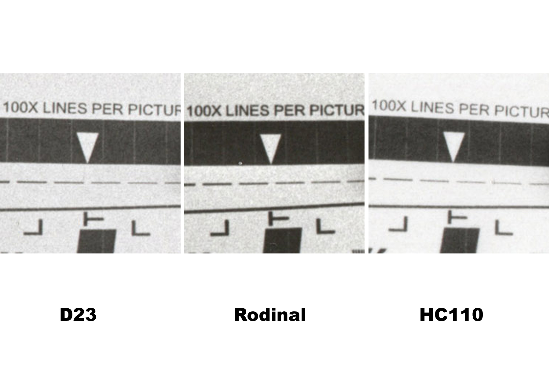

Indeed uncientific....
Try to focus the camera to the place you enlarge...
Density on film and on print dramatically affects grain perception. As does focus.
The scans of the whole pictures are big enough for you to analyze all the areas of the print, make sure you click on the "open in new window" button and you can zoom in. The focused area is the writing "Values in 100x lines".
I believe that rendition of out of focus area *is* of interest to the photographer, this was not a lens resolution test.

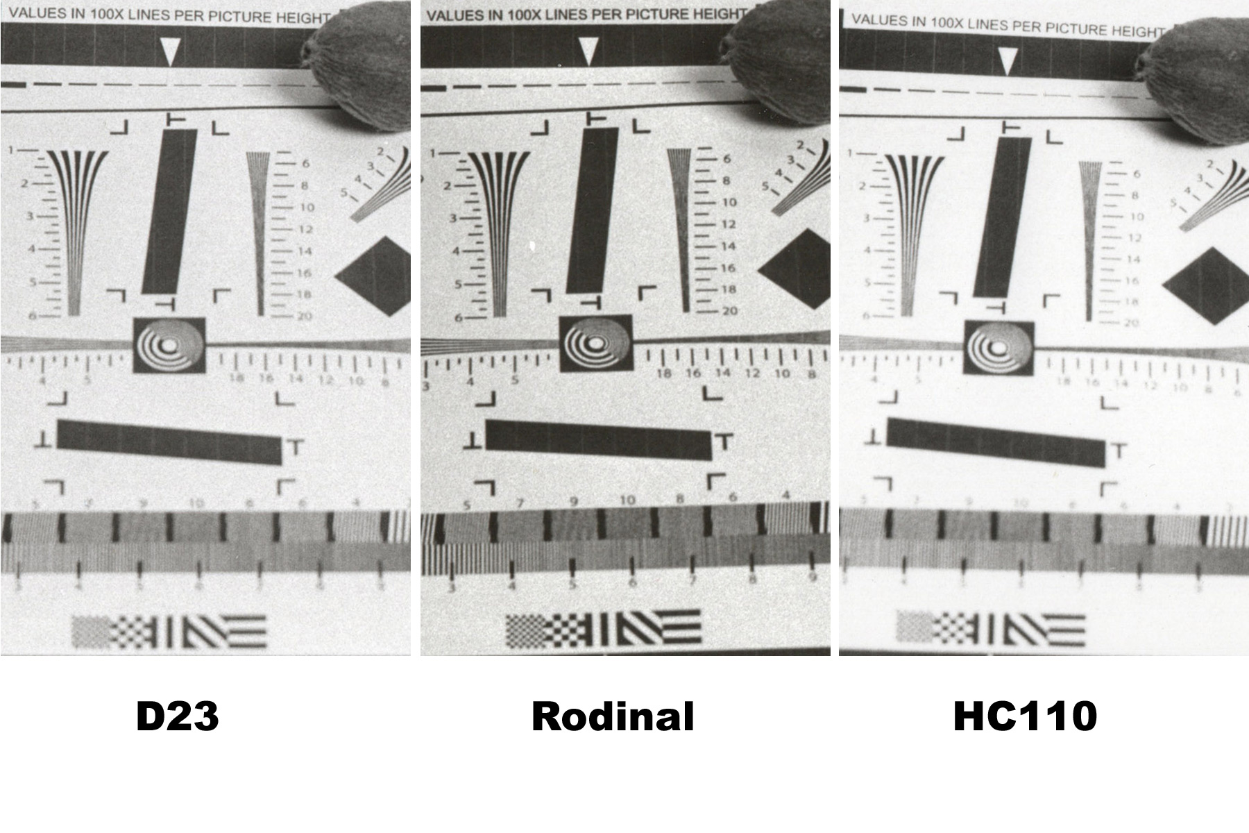

I don't wish to belittle the test but I did a little test myself in photoshop and it does appear that there is a difference in depth of field between the 3 photos.
Have a look below but remember my example is also unscientific.:happy:
Unfortunately, it makes it hard to access the grain when part of the image appears blurred.
I think you may get a better idea from viewing the middle of the photos.
Like here.
